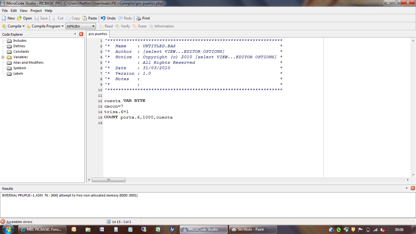

statment not recognized

    Are you installing an older version of MicroCode Studio?
    If so, there are a few steps required to make it work.
    <hr>
    When installing MicroCode Studio from the black/white CD you have to ...
    1. Right-click the Install program and "Run as Administrator".<br>
    2. Enable XP compatibility for the newly installed CodeStudioPlus.exe program.<br>
    3. Run the online update for MicroCode Studio. Being careful to read all the instructions.
      You may have to download and rename files to complete the update.<br>
    4. Once it has been updated to version 3.0.0.5, turn XP compatibility OFF for CodeStudioPlus.exe.
      Leaving compatibility turned on will generate run.pif errors.<br>
    5. Install MPLAB.
      If you have PicBasic Pro version 2.50 or previous then MPLAB 8.15a is the last version you should use.
      It's available from ... http://www.melabs.com/support/mplab_old_versions.htm
      If you have PicBasic Pro version 2.60, download the latest version from Microchip.<br>
    6. In MicroCode Studio, go to View > Compile and Program Options > Assembler tab.
      Click the "Find Manually" button and point it to the new MPASM installation ...
      C:\Program Files (x86)\Microchip\MPASM Suite ... Or wherever you installed it.
      Check the "Use MPASM" check box.<br>
      PM.exe is a 16-bit program and will not run on 64-bit systems. So all programs must be assembled with MPASM.
    MicroCode Studio should now compile in Vista/Win7-64.<hr>

    Thank you all!!! The issue was resolved!!
