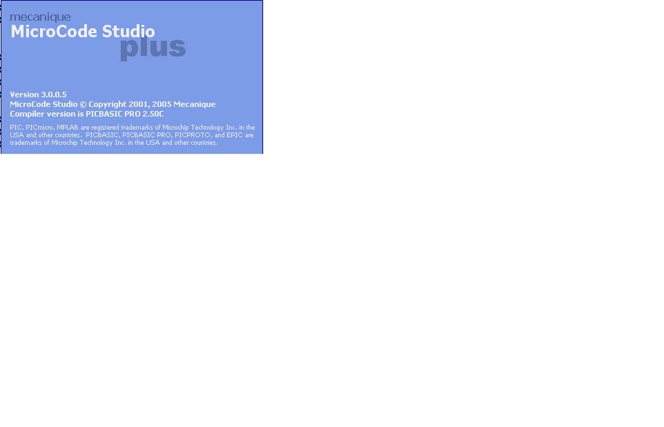

    Hey All
    I have being off pic programming for quite a while now due to other commitments
    i have only just come back and wanted to continue with my beloved 18F452
    and my LAB-X1 Experimenter Board only to find that microchip are recommending the 18f4520 for new designs.
    my problem is that i use pbp 2.50 with microcode studio plus but the loader does not contain the bootloader code for the 18f4520 .
    i have emailed Mecanique about this since monday but they haven't so far replied to my email.
    i have done the online update but its still not there.
    I am presently going through the data sheet of the 18f4520 to see what are the things that i need to change in my code the one thing i never used in my program was the caparator all other things are just normal stuff like LCD, A/D
    i am i opening up a can of worms with the 18f4520 or is it as easy to use as the 18f452.
