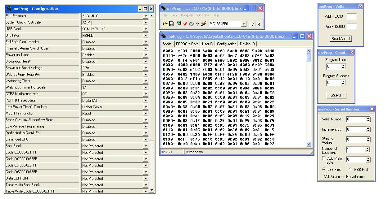

    Byte_Butcher,
    Ok, I am just curious here. What type of programmer are you using? I never need to include the "__CONFIG" or the "@ DEVICE pic16F628, INTRC_OSC_NOCLKOUT" lines in my programs. I use the U2 Melabs programmer and it comes with software that takes care of all of this for you. You just change the settings in a pulldown menu and that's it. It's a lot easier and that way I don't make mistakes like forgetting to enter a setting or spelling issues, etc. I attached a picture of my programmer with settings for a PIC18F4550 for a USB project that I'm currently working on.
    http://store.melabs.com/prod/u2/U2.html
    Darrel,
    Will this software work for a 18F46J50? Or, do I need to use the inc file like you suggested to Byte_Butcher? Thank you.
