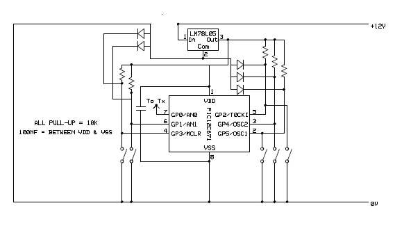

    Hi, for some reason when I check the voltage on all pins, every pin except GP3 has 5V, whereas I don't know why GP3 is showing only 0.5V. They all are held high (5V) with 10K.
    I also tried with 1K then 470Ohm, but voltage on GP3 is not going above 0.8V after that. Also just want to add that, my circuit is in such a way that it only gets power when a button is pressed. Buttons bring in the -Ve supply to the system from a 12V battery, also the -Ve goes to the 7805 so PIC gets its 5V as well.

    Unhappy Too bad
    Quote Originally Posted by financecatalyst View Post
    That looks much like a fried pin ... as it is an " input only " pin ...
    You have to take care of these pins ... cause there's no clamping diode to VDD : must be treated as a full CMOS input with antistatic discharges handling precautions.
