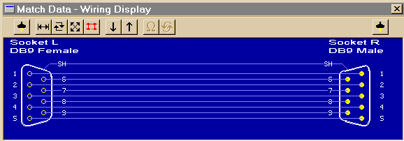

    I'm still not 100% on the cables I need though. On this PC (DELL) I've have USB only but on my old m/c I have USB and a serial port on the back.
    So should I just buy a serial cable and fem & male db converter or do I buy a usb.
    Here's the link to a website I've found which seems pretty good:
    http://www.cabling4less.co.uk/Data_C...FdGX2AodE28VFQ
    If it was me I would use the old computer with the serial port for the machine to send data to
    while using the new machine for coding and programing.
    If you do it that way then one of the Female to Female cables should be fine. Cut it in half, plug into the computer and the wires can go to the bread board.
    You will have to use an ohm meter to ring out which wire is which and you will probably have to solder thicker wires to the cable to work with the bread board.
    You will only need, in most cases, the wires coming from the DB9 connector, 2, 3, and 5.

    Hi mackrackit,
    If it was me I would use the old computer with the serial port for the machine to send data to while using the new machine for coding and programing.
    I'm happy with that.
    Another LEDave silly question coming up. Are we saying I should buy the top cable from the link below and cut one end off then meter the cable / pins out?
    If that's right, how about buying the top cable and the 'Cabling4Less DB9 Data Gender Changer (M-M)' (three quarters of the way down the page) and soldering the wires onto that?
    Might be a bit difficult to solder to that.
    You could buy some " ends " as if you were making a cable ans solder to that and not cut the cable.
    My way you end up with two cables. Just buy one long enough to fit the way your bench is set up. End up with two one meter cables?
