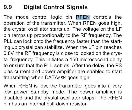

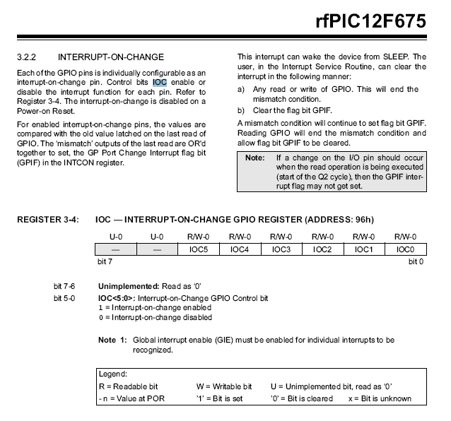

    I'm having a problem getting the rfpic transmitter to Tx when I want it to. I've set up an ON INTERRUPT with DISABLE - RESUME - ENABLE and have the INTCON & IOC set at:
    INTCON = %00001000 & IOC = %00011000
    What happens is, when buttons GPIO3/4 are pressed (and released)the RFEN led after a 5sec delay briefly flashes but no data is sent. If GPIO.3/4 are pressed and held down after 10 secs the RFEN led lights up the five seconds later (button still held down) data is Tx'd, the button is then released and five seconds later the RFEN led goes out.
    What I'd like is for the buttons GPIO.3/4 to be pressed, ON INTERRUPT runs then five seconds later after the delay loop the data is Tx'd. Does anyone have any idea on what's going wrong?

    Name:  RFRXD0420.pdf - Adobe Reader_2011-05-12_09-34-44.png
    does
    this PIC have interrupts? On the pins you want them?
    Hi Joe, from the data sheet (pasted above) so yes IOC on pins I need.

    Use DT_INTS for fast reliable interrupts, maybe will not fit a 675.
    I'll have a look into DT_INTS later today, thanks for the pointer.
    PS: Sorry for pasting Data sheet info into the thread instead of as an attachment, not sure what I did wrong there.

     E_OUT=1          ' Enable transmitter (+ lights RFEN LED on demo board)
        PAUSEUS 25       ' Allow RF stage to stabilize
    to the beginning of the
    Encode:
    block...
    Search this document for "RFEN"..
    http://ww1.microchip.com/downloads/e...doc/70091a.pdf

    The comment about dataask going high caught my eye. Maybe our timing is off a touch (not sure if or why) with the RFEN coming on and us missing data-ask going high (there is no technical reason why anything I've just typed is remotely true) Just my gut....aka....Agent Gibbs style...!
