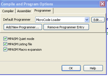

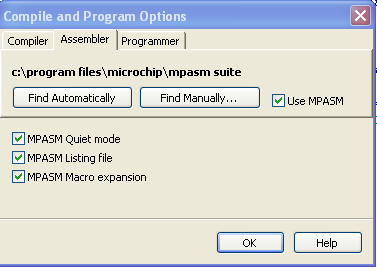

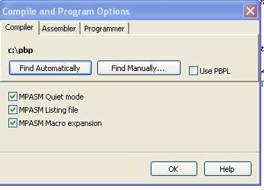

  19. #779
    You do not have to use MPLAB. MPLAB is just an editor, basically.
    But you do or should be using MPASM.
    To do this with Micro Code Studio go to Tools- Compiler Options then the assembler tab. Check MPASM.
    Good to have you back.
  20. #780
    Feb 2010
    I live in the UK
    562
    Cheers mackrackit

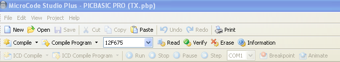

    Well I can't actually see 'Tools' on the toolbar, here are three screen shots which I think show my current setup:
  21. #781
    Feb 2010
    I live in the UK
    562

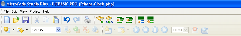

    I thought I'd add a screenshot of the 'toolbar' so you can see what I've got highlighted and what's greyed out under current settings. Does this look ok to you?
  22. #782
    That looks about right for that chip. You should have save available though! Maybe you need to have some code in the window for that. Looks like most of the greyed out options are for the in circuit debuger. Some other chips: 16F627(A), 16F628(A), 16F73, 16F74, 16F76, 16F77, 16F870, 16F871, 16F873(A), 16F874(A), 16F876(A), 16F877(A), 16F87, 16F88, 18F242, 18F248, 18F252, 18F258, 18F442, 18F448, 18F452, 18F458, 18F1220, 18F1320, 18F2220, 18F2320, 18F4220, 18F4320, 18F6620 and 18F8620
    have an in circuit debug available for them, but as you can see, they are a bit limited. It is an interesting feature though.
    Walter
    http://www.scalerobotics.com
  23. #783
    Feb 2010
    I live in the UK
    562
    Hi Walter
    Exactly that, I added some code and 'Save' changed from greyed out to Bold.
    That was interesting, I changed the chip from a 12F675 to a 16F627(A) and the RUN-STOP-STEP-PAUSE changed from greyed out to Bold,
    like you said then that must be because the chip has a Debug available to them (I've never used Debug).
    Cheers: Dave

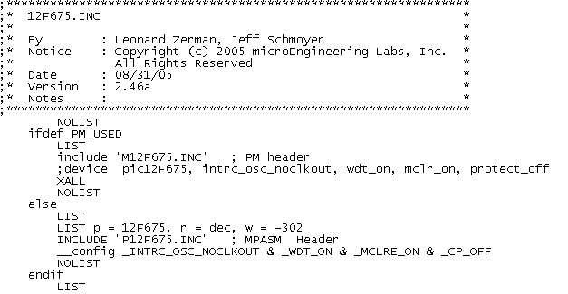

    We've touched on this before, when I compile Bruce's TX program I get these errors (see attachment). This is because as mackrackit said earlier in the thread:
    Bruce is using PM for an assembler in that example.
    And:
    PM is the assembler from the Pic Basic folks. It works well on the older and smaller chips.
    Also:
    MPASM from MicroChip works for everything.
    So the compiler error is due (I think) to having the wrong type of configuration fuse in Bruce's program (see second attachment) and I need to change them to this type (see third attachment) and it will compile.
    Have I got that right?
  27. #787
    You will want to change these lines in your code
    @ DEVICE PIC12F675,MCLR_OFF,INTRC_OSC_NOCLKOUT,WDT_OFF,BOD_OFF
    @ DEVICE PWRT_ON,PROTECT_OFF
    to
    @ __config _INTRC_OSC_NOCLKOUT & _WDT_OFF & _MCLRE_OFF & _CP_OFF
    when using MPASM as an assembler.
    And comment the *.inc file in the PBP directory.
    http://www.picbasic.co.uk/forum/cont...o-your-Program
  28. #788
    Feb 2010
    I live in the UK
    562
    Hi mackrackit,
    Well I changed the lines of code and compiled the program without commenting the the *.inc file in the PBP directory and the compiler gave the error below(see attachment). I was expecting that as per your Forum link.
    It's the
    that's causing me the problem and I've conFUSED myself big time here. The only .INC files I can find are in this path:C:\Program Files\Microchip\MPASM Suite. I've read the Forum page link you posted up but I still can't see what I need to do.
    Another pointer if poss please.
    LedimDave
  29. #789
    C:\PBP
    That is where the inc's are. If things are installed in the default location.
    The ones in the MPASM directory do not modify.
  30. #790
    Feb 2010
    I live in the UK
    562
    Can't believe I couldn't find the PBP.INC files talk about under my nose
    Anyway moving on, I've found the 12F675.INC (PBP) file and think I've 'commented out' the right line (see attachment) which probably means I haven't Is what I've done what I'm meant to do?)
    ;device  pic12F675, intrc_osc_noclkout, wdt_on, mclr_on, protect_off
  31. #791
    Yes, that is the correct line to comment when setting the fuses PM style in code space. Comment the line starting "__ config" when using MPASM style.
    Both can be commented at the same time.
  32. #792
    Feb 2010
    I live in the UK
    562
    Hi mackrackit,
    I did both and the TX program compiled with no errors In the morning I'll change the RX fuses and then it's onto the programs themselves to send and receive the bird_box_count_data, exciting stuff.
