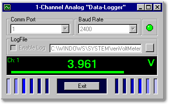

    I sometimes think DT is part machine The stuff he comes up with is invaluable around here. I am just happy that he shares his hard earned knowledge.
    The GUI from Bruce's site I think is written in Visual Basic. Here is something he has to offer.
    http://www.rentron.com/AD_LOG.htm
    Do you have a language for the PC that you use? You could make you own.
    Thanks for that mackrackit.
