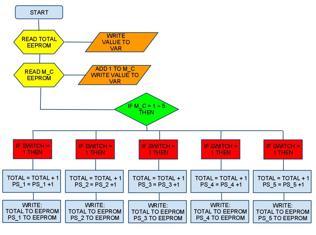

  16. #456
    In think you got it now.
    I made this up but you may not need it, sometimes even a "bad" flowchart helps.
  17. #457
    Feb 2010
    I live in the UK
    562
    Brilliant flowchart mackrackit
    Yes over the last hurdle now (I think). I've got PS_1-5 counting their own totals. Small problem in that the counts started from one all the time, then I realised that the button condition could set the count which your flow chart confirmed
    All being well the 'Mission' will be completed tomorrow.
    Watch this space...

    DEFINE LCD_BITS     4
    DEFINE LCD_LINES    4
    DEFINE LCD_COMMANDUS 2000
    DEFINE LCD_DATAUS 150
    DEFINE OSC 4
    TOTAL  VAR WORD  'STORED IN EEPROM LOCATIONS 0 AND 1
    PS_1   VAR WORD  'STORED IN EEPRON LOCATIONS 2 AND 3
    PS_2   VAR WORD  'STORED IN EEPRON LOCATIONS 4 AND 5
    PS_3   VAR WORD  'STORED IN EEPRON LOCATIONS 6 AND 7
    PS_4   VAR WORD  'STORED IN EEPRON LOCATIONS 8 AND 9
    PS_5   VAR WORD  'STORED IN EEPRON LOCATIONS 10 AND 11
    M_S    VAR BYTE  'STORED IN EEPRON LOCATIONS 12
    AV_Parts_Run var word 'STORED IN EEPRON LOCATIONS 13 AND 14
    clear                 'Re_set volatile memory to zero (Not EEPROM?)
    MAIN:
    gosub MC_S            'Set & increment M/C Starts Total subroutine
    gosub Power_up        'On Power_up GOTO READ EEPROM subroutine
    Start:
    if PORTA.5 = 0  then  count_up: 'Button pressed start counting
    IF PORTA.5 = 1  THEN     Start: 'If button not pressed loop until it is
    Count_up:                 'Button has been pressed
    let Total = Total + 1     'Add one to value of Total taken from EEPROM
    LCDOUT $FE,2,"Total=",DEC TOTAL  'Display Total on LCD
    Write 0, Total.HIGHBYTE   ' Write high byte of Total word to EEPROM
    Write 1, Total.LOWBYTE    ' Write low byte of Total word to next address
    gosub Parts_Run           'Number of parts made
    GOTO START:
    MC_S:                     'MC Starts subroutine
    READ 12, M_s              'Read current number of M/C Starts
    LET M_S = M_S + 1         'Increment value by one
    WRITE 12, M_S             'Save new value
    READ 12, M_s              'Read latest value
    pause 150                 'Give LCD a chance to Power_up
    LET M_S = M_S             'Set value to display
    LCDOUT $FE,$C0, "Machine Starts=",DEC M_S 'Display M/C Starts on LCD from EEPROM
    Power_up:                 'Power_up subroutine
    Read 0, Total.HIGHBYTE	  ' Read high byte
    Read 1, Total.LOWBYTe     ' Read low byte
    LET Total = Total         'Set Total to value set in EEPROM Memory
    LCDOUT $FE,2,"Total=",DEC Total 'At Power_up display Total on LCD from EEPROM
                              'Memory which has been stored since Power_down
    Parts_Run:
    SELECT CASE M_S
       CASE 1
       if M_s = 1 then PARTS1:
       CASE 2
       IF M_S = 2 THEN PARTS2:
       CASE 3
       IF M_S = 3 THEN PARTS3:
       CASE 4
       IF M_S = 4 THEN PARTS4:
       CASE 5
       IF M_S = 5 THEN PARTS5:
    END SELECT
    PARTS1:
    let PS_1 = PS_1 + 1
    WRITE 2,PS_1.HIGHBYTE
    WRITE 3,PS_1.LOWBYTE
    READ  2,PS_1.HIGHBYTE
    READ  3,PS_1.LOWBYTE
    LET PS_1 = PS_1
    PAUSE 150
    LCDOUT $FE, $94,"Parts1=",DEC PS_1
    PARTS2:
    LET PS_2 = PS_2 + 1
    WRITE 4,PS_2.HIGHBYTE
    WRITE 5,PS_2.LOWBYTE
    READ  4,PS_2.HIGHBYTE
    READ  5,PS_2.LOWBYTE
    LET PS_2 = PS_2
    PAUSE 150
    LCDOUT $FE, $94,"Parts2=",DEC PS_2
    PARTS3:
    LET PS_3 = PS_3 + 1
    WRITE 6,PS_3.HIGHBYTE
    WRITE 7,PS_3.LOWBYTE
    READ  6,PS_3.HIGHBYTE
    READ  7,PS_3.LOWBYTE
    LET PS_3 = PS_3
    PAUSE 150
    LCDOUT $FE, $94,"Parts3=",DEC PS_3
    PARTS4:
    LET PS_4 = PS_4 + 1
    WRITE 8,PS_4.HIGHBYTE
    WRITE 9,PS_4.LOWBYTE
    READ  8,PS_4.HIGHBYTE
    READ  9,PS_4.LOWBYTE
    LET PS_4 = PS_4
    PAUSE 150
    LCDOUT $FE, $94,"Parts4=",DEC PS_4
    PARTS5:
    LET PS_5 = PS_5 + 1
    WRITE 10,PS_5.HIGHBYTE
    WRITE 11,PS_5.LOWBYTE
    READ  10,PS_5.HIGHBYTE
    READ  11,PS_5.LOWBYTE
    LET PS_5 = PS_5
    PAUSE 150
    LCDOUT $FE, $94,"Parts5=",DEC PS_5
    READ  3,PS_1.LOWBYTE
    LET PS_1 = PS_1
    READ  5,PS_2.LOWBYTE
    LET PS_2 = PS_2
    READ  7,PS_3.LOWBYTE
    LET PS_3 = PS_3
    READ  9,PS_4.LOWBYTE
    LET PS_4 = PS_4
    LET PS_5 = PS_5
    let AV_Parts_Run = (PS_1 + PS_2 + PS_3 + PS_4 + PS_5)/5
    write 13,AV_parts_Run.HIGHBYTE
    WRITE 14,AV_Parts_Run.LOWBYTE
    READ  13,AV_parts_Run.HIGHBYTE
    READ  14,AV_Parts_Run.LOWBYTE
    let AV_Parts_Run = AV_Parts_Run
    PAUSE 150
    LCDOUT $FE, $D4,"AV_Parts_Run =",DEC AV_Parts_Run

    I am on the road again with a small display but what I can see looks good!
    I take you have ran it a few times and it is working as expected?

    I added a couple things, messes up your averaging part (never gets there now) but maybe this will help.
    Other than that it is looking good!!!!
    IF M_S > 5 THEN
    M_S = 0
    IF TOTAL > 5000 THEN
    TOTAL = 0
