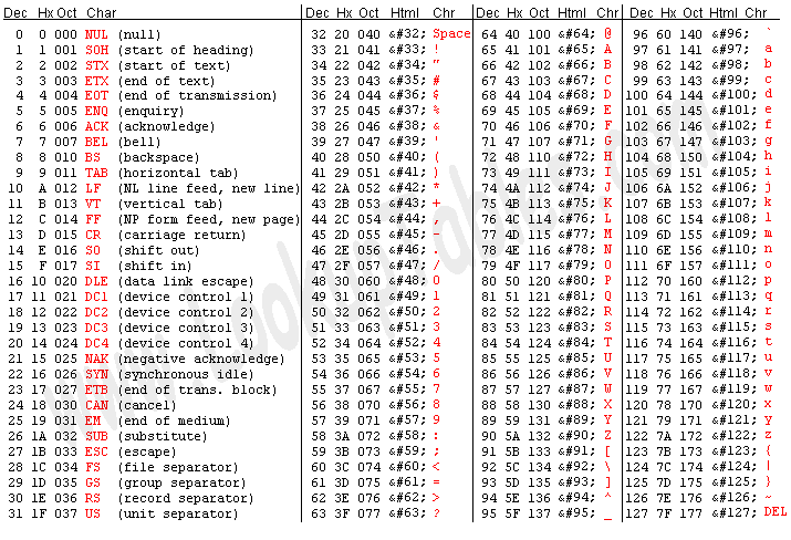

    Default A For-Next Loop
    "A,B,C..." all have an ASCII value. For example "A"=65 so an iteration like this can help
    For I = 0 to 25
    char[I] = I + 65
    Next I
    P.S. PBP Manual has the ascii chart

    Quote Originally Posted by sougata View Post
    For I = 0 to 25
    char[I] = I + 65
    Next I
    As I look at this a year later, I now understand what this snippet does.
    "I realise there are likely easier ways to load the ARRAY . . .Baby Steps"
    It loads the variable CHAR with the Alphabet,<font color = BLUE> A Belated Thanks, Sougata .</font color>
    This response is to point that fact out to anyone new to arrays. Attention Newbies
