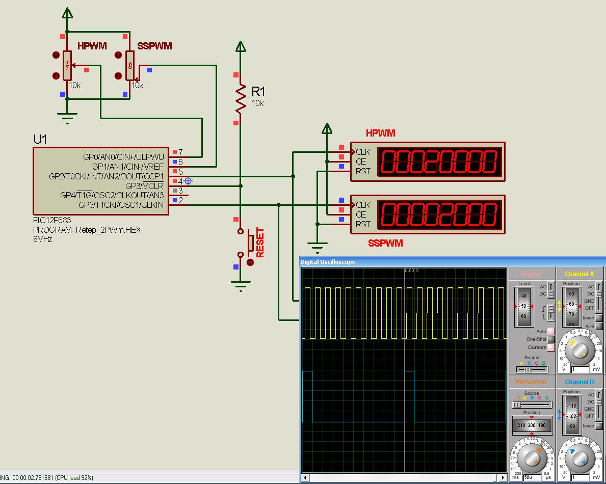

    Tonight, I do this ...
    Next year, you may try it.
    DEFINE OSC 8
    SPWMpin  var GPIO.5     ' Output Pin for SSPWM
    INCLUDE "SSPWM.inc"     ' include the SSPWM module
    ;----[Constants]------------------------------------------
    HPWMfreq        CON 20000
    Freq = 2000             ' Set Frequency of SSPWM (word)
    ;----[Variables]------------------------------------------
    HPWMduty        VAR BYTE
    LastHPWMduty    VAR BYTE
    SSPWMduty       VAR BYTE
    ;----[Initialize]-----------------------------------------
    OSCCON = %01110000      ' 8Mhz
    ANSEL = %000011         ' AN0 and AN1 ANALOG
    DutyCycle = 10          ' Set Duty Cycle of SSPWM
    gosub StartSPWM         ' Start SSPWM @ Freq/DutyCycle
    HPWM 1, 127, HPWMfreq   ' Start 20Khz PWM @ 50%
    ;----[Main Program Loop]---------------------------------
        ADCIN 0, HPWMduty
        ADCIN 1, SSPWMduty
        IF HPWMDuty != LastHPWMduty THEN
            LastHPWMduty = HPWMDuty
            HPWM 1, HPWMDuty, HPWMfreq
        DutyCycle = SSPWMduty*80/256+10  ' scale SSPWM dutycycle
        gosub SetSPWM                    ' Change SSPWM DutyCycle
    GOTO Main
    Dutycycle of the 2Khz is 10% in the image.
    Both dutycycles are adjustable from the pots, and works from 10% to 90%, (0 to 100% for the HPWM).
    Don't forget to comment the wsave vars not used by the 683 in the .inc file.
    Happy Holidays.

    ;HPWM 1, HPWMDuty, HPWMfreq
    ; ENDIF
    ;DutyCycle = SSPWMduty*80/256+10 ' scale SSPWM dutycycle
    DutyCycle = 95        ' set 95% nominal SSPWM dutycycle
    GOTO Main
    Maybe after all I will not need changes in ASM.
