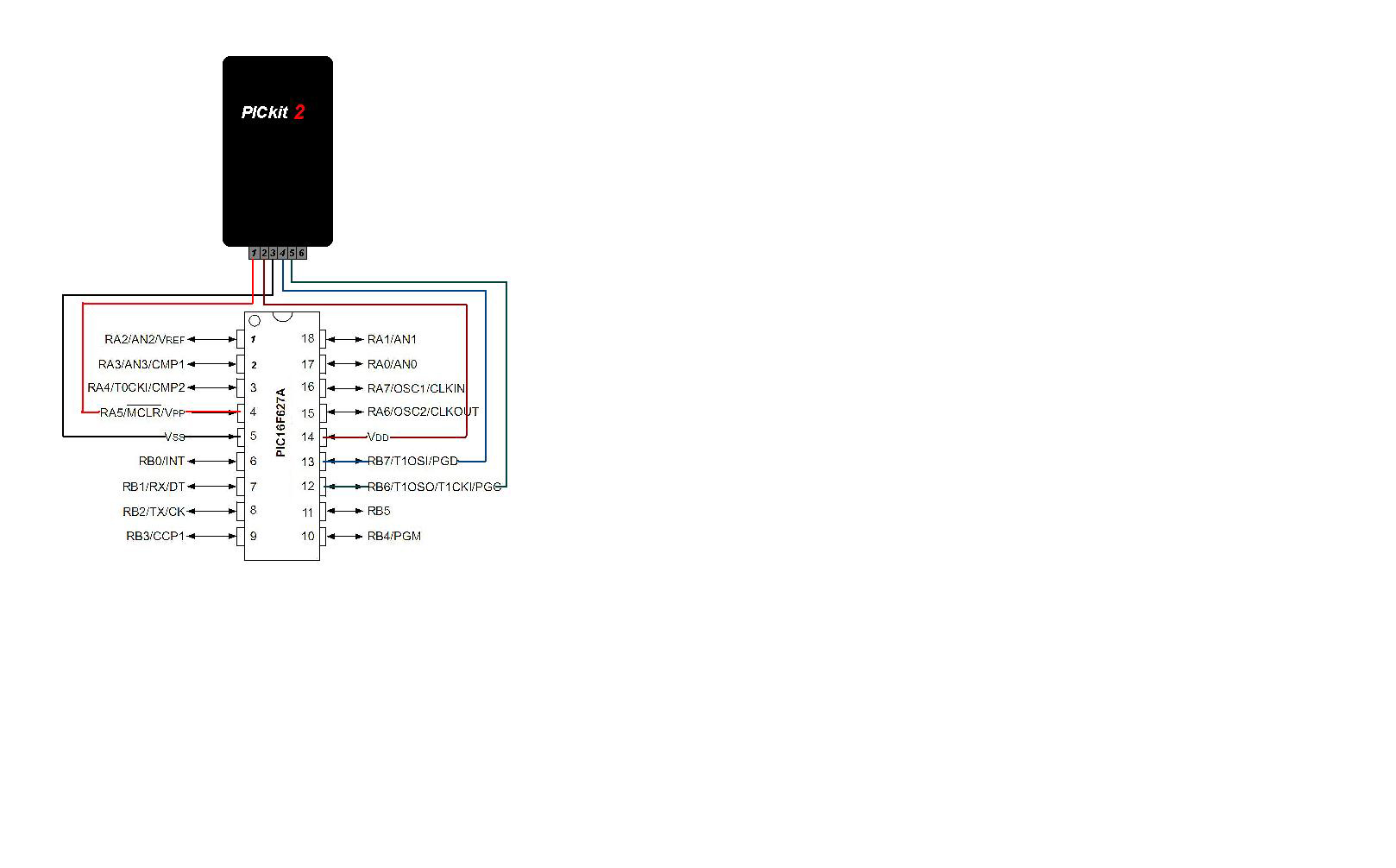

    Let us see how you connect the PICKIT2 to your 16F627A with the rest of your circuit. Maybe you made some wrong connections.
    Give us a drawing or some good photo's
    Jul 2007
    67
    This is how it was before I hooked up the LED

    That should be no problem.
    If you did it like that and nothing else connected to the chip, it must programm it.
    There is ofcource still another possibility!
    The porgramm you wrote, sucks!
    The rest of your connection and or powersupply is not good.
    Sorry for this language but at this moment nothing else came to my memory.
