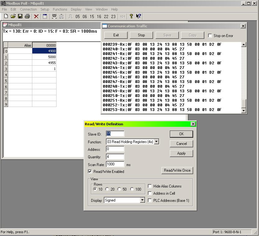

    Default My simulator setup
    FYI - here's a screen shot of my Modbus Poll simulator screen and setup:
    Hope the image shows OK

    Default Success!!!! :)
    Also,
    If I enter [0F 03 00 00 00 04] as sent from the host above, it shows 0x2745 for the CRC, which is the same thing the host sent.
    So that has to be the right algorithm.
    <br>
    Hey Darrel,
    You gave me the final clue - it was a byte order issue I needed to reply with the bytes reversed: D2 0F. Your result above clued me in!
    Thanks much - see screen shot showing no errors.
    Guy
