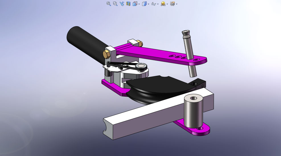

    I've shelved my encoder digitizing arm project at the moment, in favor of another encoder project that is viable now...and it only involves 1 encoder.
    Here's what I've got:
    This project is intended to measure the angle of a die in an air-over-hydraulic tubing bender.
    Maximum angle measurement of bend will be 190 degrees.

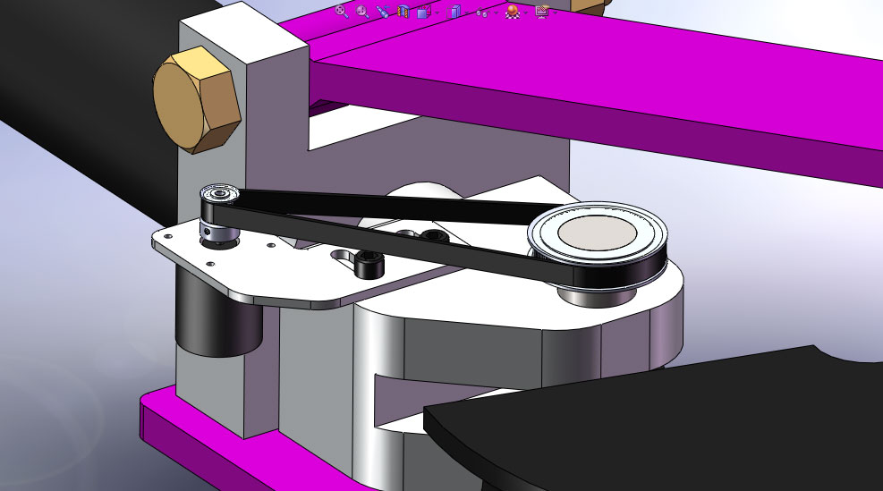

    Belt drive reduction:
    Encoder: 10 Tooth 3mm HTD
    Die: 44 Tooth 3mm HTD
    Ratio: 4.4:1

    The couple of pics are for reference.
