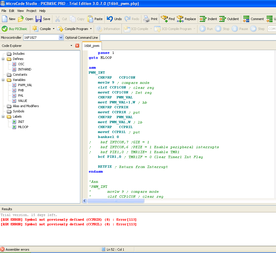

    intcon bits 6 and 7 should already be set , setting them again should do no harm
    pie1.0 is also set , setting it again can't hurt
    That is exactly what I thought and could not find anything to indicate otherwise in the datasheet.
    the problem lies elsewhere, PWM_VAL must be > 30 ,values from 0-29 wont work could that have happened
    No I started PWM_VAL for zero and incremented up in steps of 1 and it worked all the way rolling over and starting from 0. If 0-29 does not work I could not detect it with my voltmeter.
    I'm using a cro those <30ish pwm's cause the output pin to be permanently high when you expect a very small pw , in real life that could be nasty
    try a loop range yourself of 0 to say 28
    Just tried it no problem 0 gave 0 volts 9 gave 3 mV.

    not on a cro
    using a main loop like this
    MAIN:
    PWM_VAL = PWM_VAL+1
    PAUSE 500
    if pwm_val > 29 then pwm_val=0
    toggle portd.1
    Goto MAIN
    I will take your word for it as I have no instrument that will replicate your results, and as I have found in the past just because I can not see it does not mean it is not there.
