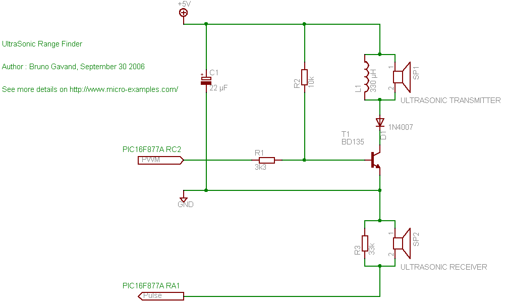

can anyone here can convert this in picbasic pro?
Results 1 to 3 of 3
    Nov 2009
    12
    Post can anyone here can convert this in picbasic pro?
    please help me to convert it in picbasic pro.. thanks
    * description :
    * This is a basic ultrasonic range finder, from 30 to 200 centimeters
    * target device :
    * PIC16F877A with 8 Mhz crystal
    * or any PIC with at least one ADC and PWM channel
    * configuration bits :
    * HS clock
    * no watchdog
    * no power up timer
    * no brown out
    * LVP disabled
    * data EE protect disabled
    * ICD disabled
    * see more details and schematic on http://www.micro-examples.com/

    Hi, ReianJim
    Do you know the Mikro C Compiler demo is free ... ( look in the Archives section for V 8.2 )
    My friend Bruno ( Brunog ) Will be glad to help you ...
    PS : How much do you offer for the translation ???
    4,184
    This circuit may work, but I would put an amplifier on the receiving end. This could reach almost 10 meter on a good design.
    As for the translation, why not make it from scratch? You will learn something in the process.
    It is more than sure that the translation of a C program will have difficulties.
