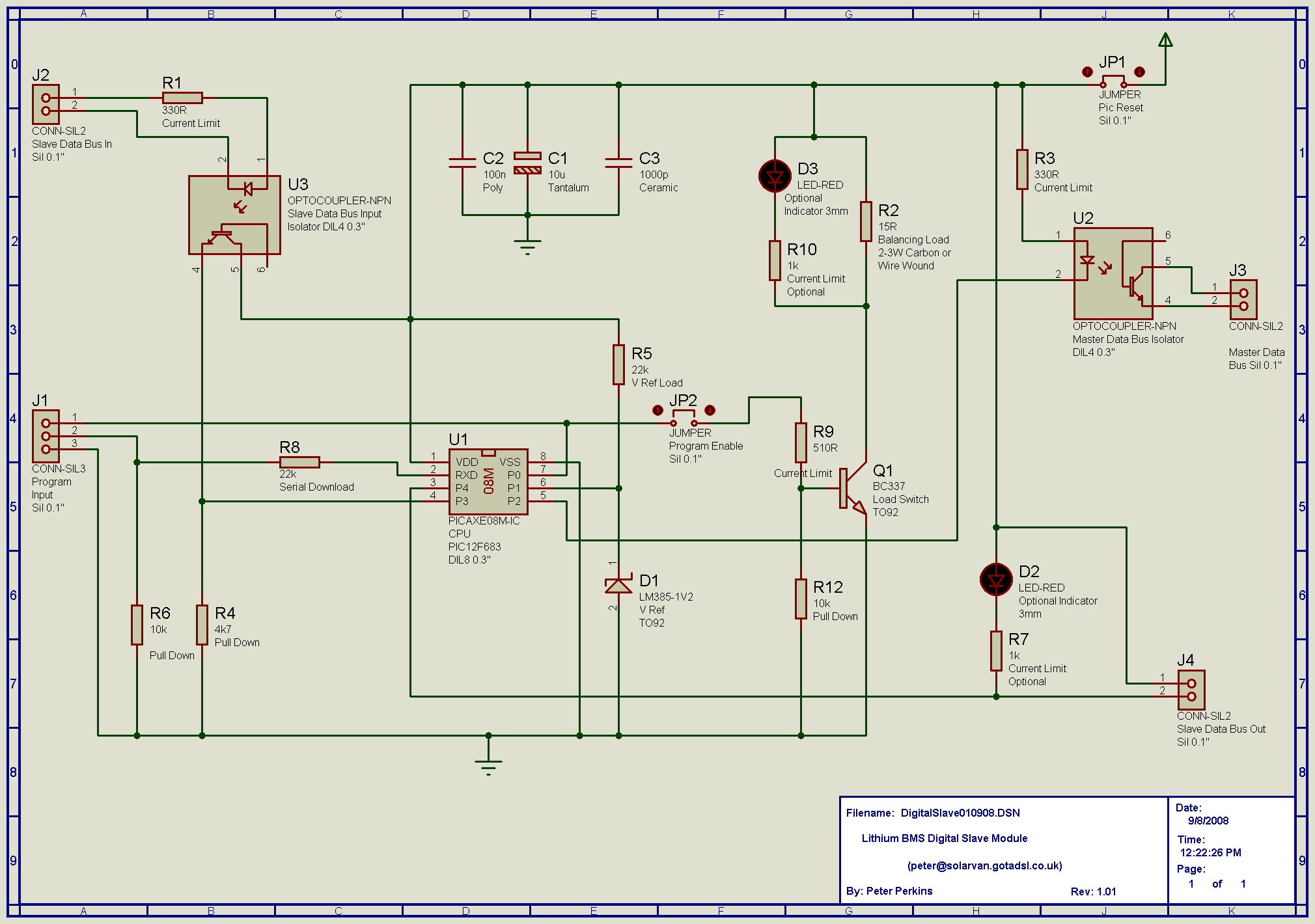

    My code is below and turns on/off a led/load on output 0 depending on the pic supply voltage. It was designed using a picaxe chip which works well but I want to migrate to pbp and non picaxe chips.
    The adc part does not seem to be working I suspect my config/defines. Can someone have a look for me please.

    My schematic is here if it helps.
    www.solarvan.co.uk/bms/DigitalSlave080908.jpg

    I sometimes have problems with adc_in. Try this piece of code where you want to adc_in:
    ADCON0.1 = 1   'Start ADC conversion
    while ADCON0.1 = 1 :wend   'Wait for ADC DONE
    RefADC.highbyte = ADRESH   'Move HIGH byte of result to adcVAL
    RefADC.lowbyte = ADRESL   'Move LOW byte of result to adcVAL
    CellA = CellA + RefADC		'Add latest ADC reading to running total
    Succes,
    UB
    Default Thanks
    Quote Originally Posted by ultiblade View Post
    Succes,
    UB
    That seems to be doing the trick! Cheers.
