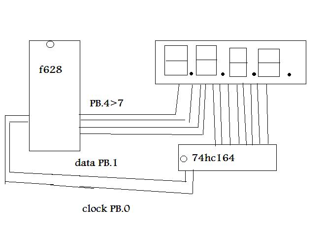

    I think it would be helpful if you include a schematic showing how your LCD is connected so other will find it easier to help you :-)
    Is it a serial LCD HD44xxxx or a 7-segment LCD?
    Does it work standalone(not connected to the pic) ?
    Does the LCD work if it directly connected to the PIC
    Which ports is it connected to ?

    SORRY ITS JUST 7 SEGMENTS NOT LCD..this is the 7segment schema i did draw sorry i havnt draw it good but im sure thats enought to undersnd its normal 7seg working through 74hc164 shift register and 4 digit pins to the pic .atached them all to portb . it works fine with a counter like b0 = b0 +1 to 9999. but i cant add any pause or delay i need to findout how to run my program apart of the 7 segment routing or loop. <<<< ITS LIKE I HAVE A LED BLINK IN A LOOP AND I WANT TO WRITE MY CODE APART AND LET THE LED BLINKIN WITHOUT STOPING EVEN OTHER PROGRAME IS WORKIN AND HAS ITS DELAYS OR NO OR SOME ITS LIKE I WANT TO RUN 2 THINGS IN 1 TIME 2 LOOPS I DONNO IF TIMRERS WILL HELP OR WAT TO WITH THIS BLLODY THINGS LOL >>>>THIS 7SED GODE WORKS OK THE TOP 1 I POSTED BEFOR ISNT WORKING ANYWAY THANK U FOR HELP
