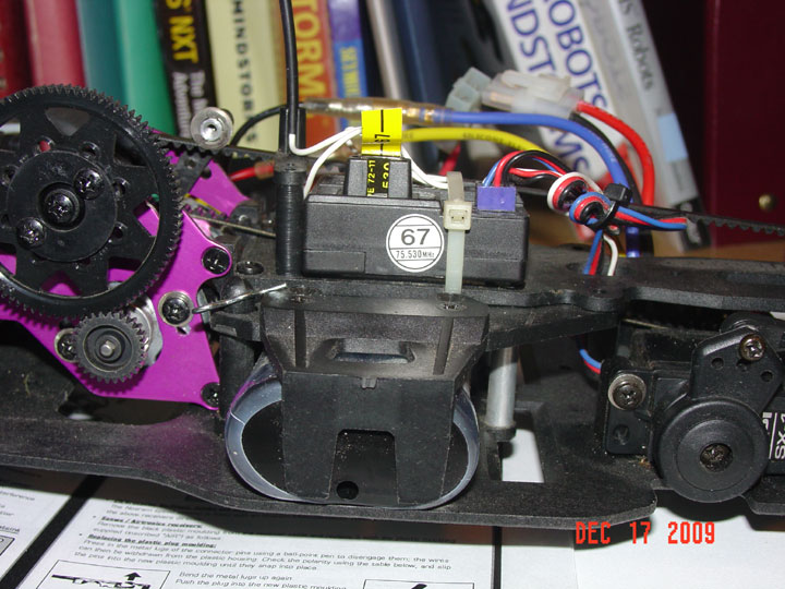

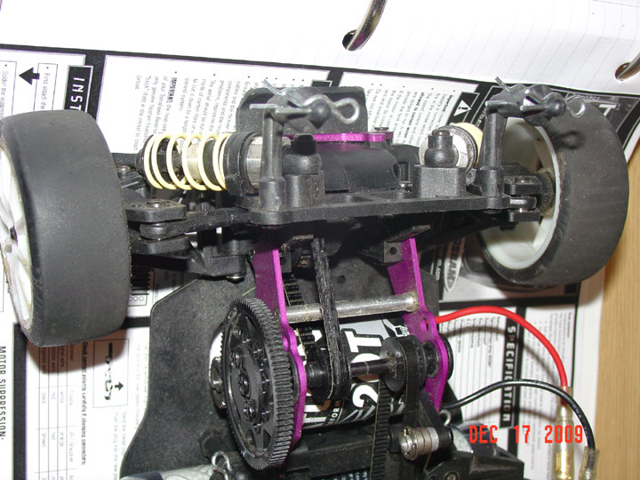

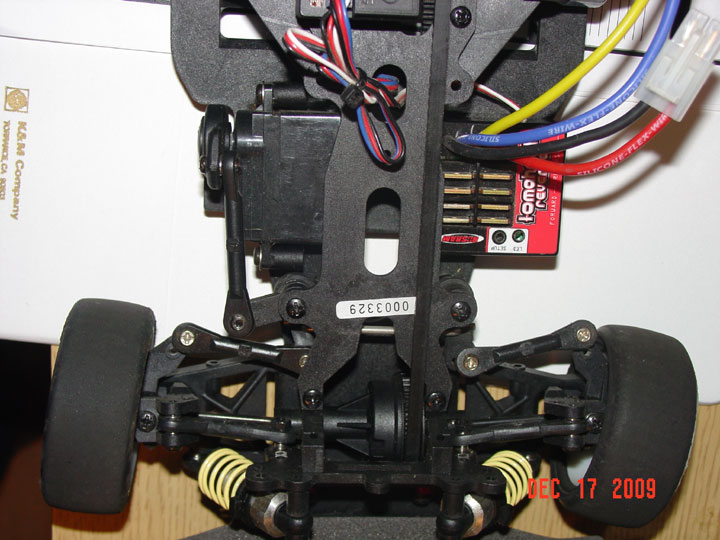

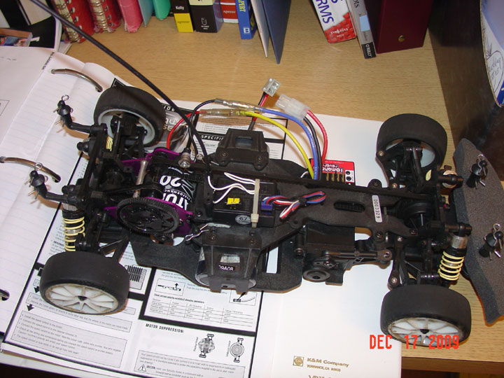

    I am now using my hobby level RC car. I am having a Vcc problem. The RC car has a 7.2v battery pack to drive the wheels. These a big batteries, but the wheels use allot of power.
    I would like to use four 1 and 1/2v AA batteries to power everything except the drive wheels. That's six volts. The PIC wants 5v. I can not find reverence to voltage regulation inside the PIC. I think I need a voltage regulator - a subject about which I know nothing. Does just inserting a 5v regulator in the Vcc line from the batteries do the job? Which 5v regulator?
    Lastly the USB port supplies a pin with 5v on it. Do I just put an ON/OFF switch in the plus 6 volt battery line and turn that source off when using the USB for programming?
    Is having three sources of power a blessing or a hindrance ?

    If you use 4 AA rechargeable batteries then you will not need a regulator, nominal voltage is 1.2 volts each. But the PIC you are using will run on 2 volts with the 8 Mhz OSC...
    So... Use any AA battery pack with a LM317 voltage regulator set to run at ~3.6 volts for the PIC. You will need three 470 ohm resistors to set the regulator. Then you should be able to fire the transistor that is triggering your relay from the PIC.
    http://www.national.com/mpf/LM/LM317.html#Overview
    The PICKIT2 has an "auto detect" setting for the voltage. if there is voltage on the PIC the PICKIT will deal with it. No switch needed.

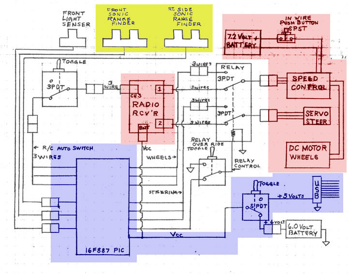

    Default A circuit diagram. My kingdom for a circuit diagram
    First things first.
    I can try to make myself a circuit diagram with a pencil. Better yet I can learn how to use CAPTURE. Then I can share it. I'll give that a shot.
    Microchip seems to make many products that interface directly with the 16F887. I have a problem picking out which are appropriate.
    Thanks.
    Ken

    Or you could use something like this during the learning/development phase (<$150 and should last you a lifetime) EasyPIC6 PIC® development system:

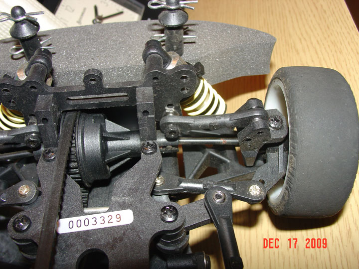

    I have the car. It uses a Tomahawk Reverse Electronic Speed Controller(http://www.nosram.com). I want to use that system directly from the RC receiver for racing. It is proven and its response is sure. It would be nice if I could get the same three wire sockets that this device is accustomed to plug into, but that seems more than I can expect.
    I plan to use DPDT switches to toggle between RC receiver control and PIC control. I plan to use the third channel on the RC system to tell the PIC to flip the DPDT switches.
    The attached pictures of the car show that it is four wheel drive (there is a drive belt down the middle). This limits my ability to attach the PIC and attendant devices. Once the PIC control works I will be able to get more appropriate 1/10 scale cars or trucks.
    I hope the pictures came out OKAY.
    Ken

    Default Oh goody! PHOTOS!
    Hey Ken, thanks for the photos! I always love to SEE peoples projects.
    So the original control circuitry is clearly all sealed up, so it looks you can't hack into it and use any of it's electronics when yer buggy is under PIC control. No problem, I was just curious.
    FWIW, here's a simple circuit that uses a MOSFET to drive a motor and a DPDT relay for direction control. You would need one PIC pin to PWM a signal to the MOSFET for speed control, and one pin to drive the relay coil. Of course, depending on how much current your relay draws, you may need another MOSFET or bipolar transistor to drive the relay coil. And a protection diode across the coil always...
    Anyway, that would give you speed and direction control on your motor.

    Default First cut at what goes where
    Attached below is my first try at which parts go where on my radio controlled car. I drew it with a Tee square and triangles. (I could not stick a thumbtack into our oak cutting board? Drawing boards were made of maple - I think)
    The parts in the red section are originally in the car.
    The blue section is hoped to be on the PICkit 2. (There is an added toggle switch which I may or may not be able to solder to that printed circuit.)
    The yellow section is two sonic range control units each on its own fairly small pc card. I need to devise a method to attach them to the car plus an electrical connection method.
    The rest, in black, is presumed to fit onto an inline prototype card.
    A big issue is the connectors. The more the better if I can make them reliable. I welcome your judgments.
    I have not included electronic details. I think I know which PIC pins to use. The three different Vdd sources (USB supplied, 6 volt battery pack and 7.2 volt battery pack) boggle my mind. If I can settle on a physical layout then resisters, capacitors, and transistors will be next.
    I need to figure out how to trigger PIC interrupts from the light sensor and the sonic range control.
    HAPPY NEW YEAR.

    Default Opps,
    More details.
    Originally the pulse width modulated signals from the radio receiver control the steering servo motor and the amplifier (speed control) which drives the DC motor.
    My design has the PIC interrupting that service by controlling the multiple double pole double throw relay switches.
    Channel 3 from the radio receiver be used to tell the PIC to toggle between autonomous control and radio control. This decision can be overridden with the toggle switch in the middle of the picture.
    Once in autonomous control the car has two means of evaluating its environment. A narrow angle lense (the cardboard tube from a toilet paper roll?) light sensitive device and two sonic range control devices.
    The light sensor could find a incandescent light bulb. Once found (by turning in a 360 degree circle for example) a simple line following algorithm should lead the car to the light source.
    The front and right side mounted sonic range controls could guide the PIC counter clockwise around the inside of a room. This idea is on the WEB at:
    http://letsmakerobots.com/node/928
    Thanks all,
    Ken
