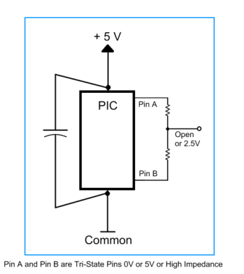

    So I found this little circuit that works well for my needs - the circuit takes one small analogue signal into an opamp & when a SPST switch is flicked, the opamp output changes from non-inverting to inverting.
    I've changed the circuit to illustrate my needs - it normally switches a ground to the non inverting pin - that's fine if you're using dual rail/supply opamp circuits - but all my circuit is single rail & therefore my opamp pins input pins aren't biased at ground potential ..........my circuit uses a single rail of 5V - therefore all my opamps are biased at VCC/2 .... 2.5V.
    So therefore rather than switch a ground to the non inverting pin (which would have been easy to do with a PIC!) ...I'm faced with having to switch 2.5V - so I'm looking for a way to get the PIC to do this with the lowest component count possible! Also, I want to avoid relays as I just don't have the PCB real estate available.
    Now Melanie touched upon a way of switching to 5V/0V from a mid 2.5V DC potential (http://www.picbasic.co.uk/forum/showthread.php?t=11163 ) ...but I can't see how I could use her clever little suggestion in this instance - because the cicuit above is an on off switch.
    Any ideas?

    Hi Hank,
    Keep in mind I have never tried anything like this.
    If you set Pin A to 5V and Pin B to 0V you should get the difference divided by the Voltage divider (2.5V).
    If you set Pin A and Pin B to “float” you should get no voltage.
    Just a theory, let us know about the reality.
    May be too much noise on the floating resistors for your circuit.
    -Adam-

    Hi Adam,
    That's worth a try (& pretty much the same as what Melanie advised in that post I linked to - but I couldn't see how I could use her suggestion in this instance)....I should get a go at it over the weekend - I'll report back.
    thanks once again.
    Mar 2009
    653
    Well, I tried it - the good news is that when the 2.5V is switched in I get a nice clean inverted signal (vs the input) as seen at the output.
    However, when I switch those pins off to remove the 2.5V (ie turn the corresponding pins into high impedance - by changing them to input pins), I get a terribly distorted waveform as seen at the output of the opamp.
    I think I'm going to have to bite the bullet and make space for some bilateral switches in my circuit :-(
    Thanks anyway.
