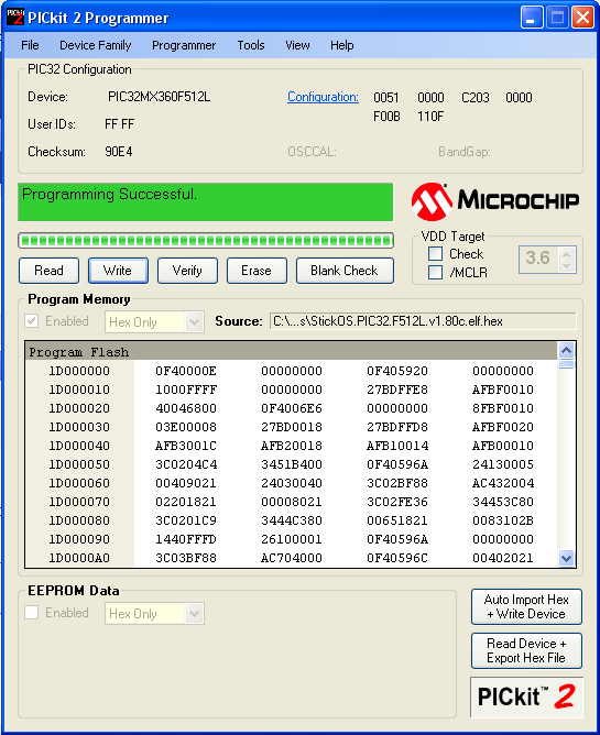

    My problem loading the BITWhacker PIC32 from PICkit 2 is that it is not capable of doing so. MPLAB tells me that I need PM3, REAL ICE, ICD2, ICD3, or PICkit3.
    MichaelS referring to PICkit3 said in a September 2010 entry:
    Yes, MPLAB doesn't like the Pickit2 for use with PIC32, but who needs Mplab to load the Bitwhacker? All you need is the Pickit2 programmer IDE. I get the message saying "Programming Successful", and the command line interface I get after doing so. The Pickit2 is perfectly capable of programming PIC32 chips. Otherwise, it would not have a drop down menu including them. I don't quite know why MPLAB is forcing the use of other programmers, but you don't really have to worry about it.

    Default I get programming successful too, but
    My PICkit2 says it works, but the code is not embedded in the chip. I think the problem is with the size of the PIC32 memory. HIDbootloader goes near the front of memory. The high address is 4A20. StickOS goes higher up. StickOS gives me the warning when I try to download it. I have been able to load HIDbootloader, but have not been able to load the OS. At one point I think I got the OS loaded but in so doing it wiped out the bootloader. Of course this is all guess work.

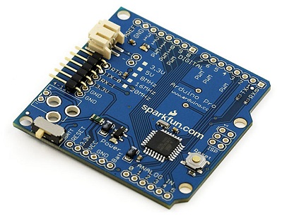

    Another option I would highly recommend is Arduino, hardware is <$20 and software is free.
    Example hardware here Arduino Pro 328 - 5V/16MHz

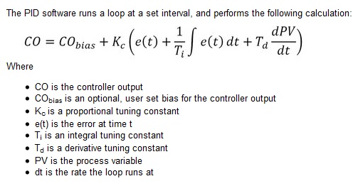

    Ken, there are 2 issues that have not been addressed since the beginning of this project.
    1. The less serious of the 2 is your use of the hardware PWM module. R/C devices, such as servos and ESC's, expect a control pulse (typically 1-2mS) at about 50Hz. You can probably go lower to 30Hz or higher to about 100Hz and things should still work fine. However, a PIC16 with a 20MHz clock (which I believe you are using) will not go below 1220Hz (PR2=0xff). Even with an 8MHz clock the lowest is 488Hz (244Hz with a 4MHz click) and is still probably to high compared to the desired 50Hz.
    2. To get a closed loop control system to work correctly, you need more than a bunch of if-then-else statements. Ideally you want to use a PID controller. A proportional-integral-derivative controller (PID controller) is a generic loop feedback mechanism. It measures a process variable (e.g. temperature), and checks it against a desired set point (e.g. 100 degrees Celsius); it then attempts to adjust the process variable by changing a controller output (e.g. PWM signal to an electric heater) which will bring the process variable closer to the desired set point. Even a simple P (proportional only) controller would be much better than what you currently have.
  26. #546
    Nov 2009
    Fitchburg, Mass
    483
    Default Pid??
    I have been wondering whether I have a basic mistake in my feedback loop. I am measuring distance and adjusting rate of speed and rate of turn. Maybe I should be measuring rates not scalars
    This means differentiating. I would need to measure two distances a fixed time apart. Then do some subtraction. I do that a little bit in my code, when I include "oldrangeright" in my state machine, but since there is no consistency to my sample time...... Rate of turn is even less clear.
    Is this the PID flaw you are suggesting? What is the solution? What are the technical limitations? Will a 16F887 do the job? Do I need C code including appropriate libraries? I do not know how to start.
    Your comments about my PWM are true. I found what works by trial and error. To get 50hz would I need to install an outside oscillator? Might I somehow divide down the internal one?

    I think you are telling me that I have not been using my PWM mechanism. In the case of turning I have defined STRAIGHT QuarterRIGHT, HalfRIGHT, RIGHT and the corresponding for LEFT. (I did not show you folks my definitions.) But I only use STRAIGHT, RIGHT and LEFT. That's bang-bang like a TOY level car. I could be doing much finer adjustments if I did a bit more arithmetic on my SONAR readings. GOOD IDEA. GOOD OBSERVATION. Presently I do comparisons in HEX. I really don't want to waste time translating to decimal.
    Thank you!!

    I can not imagine a cheapo device that will measure closing rate.
    Can a robot know closing velocity other than by measuring distances at specified time intervals and divide? Anybody seen this done with PBP (or C or C++) on a PIC? Is this the reason I will have to upgrade to a 32MX460? I would love to see sample code.

    Have you fixed the easier of your 2 issues yet? Expecting it to work correctly at 1220Hz when it is waiting for 50Hz may be a bit of a stretch. You can create a multi-channel, interrupt-driven, software PWM with a PIC16 and a 16-bit timer - such as TIMER1. If you don't know how to do that, then select a PIC18 and use DT's 2-CH Hardware Servo Driver (see CMS articles on the right of the HOME page). It is limited to only 2 channels but will work for your project for now.
    When you have that working correctly, then you can progress to the PID stuff which looks like this:
