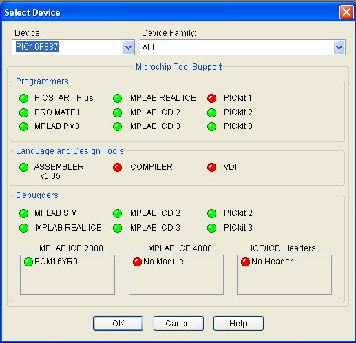

    I have been trying to activate PICkit2 Debugger per instructions in Chapter 4 of the PICkit 2 User's GUIDE DS51553E
    I could not activate the project using 16F887Demo.asm per the User's Guide because my copy of that file is empty. Strange.
    I could not activate the project using wall_racers.asm. Each time I hit "Build all" it considered for a few moments then in RED LETTERS said BUILD FAILED. No explanation. No comments. No helpful information.
    I succeeded in activating a debug project using blink.asm from C:\PBP\PK2 Lessons\44 Pin Demo Board\02Blink.
    I have not the faintest idea what I have learned with this exercise. I know from the listing file which RAM locations I wish to read. I think I could figure out where to place the break point if I could get the debugger to accept the wall_racer.asm code.

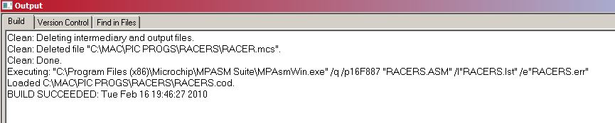

    Thanks macracket. Shortening the name made MPLAB happier. It actually tried to build my PBP code, but was very unsuccessful. Understand this is exactly the code that can be built, downloaded and run by PICkit 2 debugger software.
    MPLAB is not happy with the formate of the .asm code created by PBP. Below is a small snip of a huge list of complaints.
    Error[122] C:\PK2 LESSONS\44PIN DEMO BOARD\RACERS\RACERS.ASM 235 : Illegal opcode (_blinkloop45)
    Error[122] C:\PK2 LESSONS\44PIN DEMO BOARD\RACERS\RACERS.ASM 238 : Illegal opcode (_rangefront)
    Error[122] C:\PK2 LESSONS\44PIN DEMO BOARD\RACERS\RACERS.ASM 241 : Illegal opcode (_blinkloop67)
    Error[122] C:\PK2 LESSONS\44PIN DEMO BOARD\RACERS\RACERS.ASM 244 : Illegal opcode (_turnon)
    Error[122] C:\PK2 LESSONS\44PIN DEMO BOARD\RACERS\RACERS.ASM 247 : Illegal opcode (_steerto)
    Warning[207] C:\PK2 LESSONS\44PIN DEMO BOARD\RACERS\RACERS.ASM 250 : Found label after column 1. (GOTO?L)
    Error[122] C:\PK2 LESSONS\44PIN DEMO BOARD\RACERS\RACERS.ASM 250 : Illegal opcode (_main)
    Warning[207] C:\PK2 LESSONS\44PIN DEMO BOARD\RACERS\RACERS.ASM 253 : Found label after column 1. (LABEL?L)
    Error[122] C:\PK2 LESSONS\44PIN DEMO BOARD\RACERS\RACERS.ASM 253 : Illegal opcode (L00001)
    It would appear that PBP folks don't use MPLAB. True?

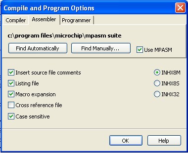

    Default Attached is my racer.bas code
    Here is the file that I have been compiling with MicroEngineering MicroCode Studio PICBasic Pro compiler, building with MPASM and programming with PICkit 2 successfully.
    The assembly language result from this MicroCode Studio compile is not acceptable to the Microchip PICkit 2 Debug Express MPLAB IDE.
    It says in RED "BUILD FAILED"
    OH! I see now. It is complaining about PBPPIC14.LIB lines 607, 623, 640, 643, 649 etc.
    These are all "if" statements that look like this:
    7785 if ($ > 800h)
    541 if ($ == (Label))
    552 if (((Label) & 800h) == 0)
    559 if (((Label) & 1000h) == 0)

    Because I am still using PBP 2.50
    I compiled in MCS then created a project in MPLAB using the ASM from MCS work as the source.
    No problems here.
    Just wondering if you are selecting the correct PIC???

    Default Still no go with debugger...
    macracket:
    I changed the do loop to a WHILE WEND loop. It compiled fine, but still would not assemble in the MPLAB Debugger. Same problem with the PICPBP14.LIB "if" statements. How can the .LIB files be at fault? Very strange. Sounds like some kind of compatibility problem.
    Attached is my Device Select 16F887 Window. It looks a little more flexible than yours, but basically the same

    Default Maybe we are not doing the same thing...
    1-- Write and compile the code using MCS.
    Compile PIC BASIC PRO code using
    MicroCode Studio version 3.0.0.5
    PICBASICPRO 2.6.0
    2-- Generating the ASM file with MCS set for MPASAM use
    Using MPASM per the following picture:
    3-- Open a project in MPLAB.
    Open the project in MPLAB IDE 8.43.00.00
    MPDebugger 3.10
    4-- Use the ASM file generated by MCS as the source for the MPLAB project.
    5-- Everything is in the same project directory.
