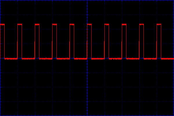

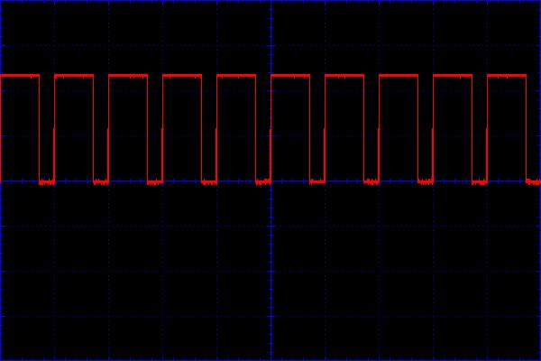

    Great idea Ken. I don't know how much you have modified hardpwm.bas, but here it is in it's native form. First pic is about 20 percent, and second pic is about 80 percent (of a 1ms pulse):
    You will notice that the min is about 0.2ms and max is 0.8ms.
    Your servo or speed controller requires a pulse width between 1.0ms and 2.0ms. It would probably like to see these pulses every 20ms or so, not every 1 ms (as seen here).
    And here is what you want it to look like (from my rc receiver):

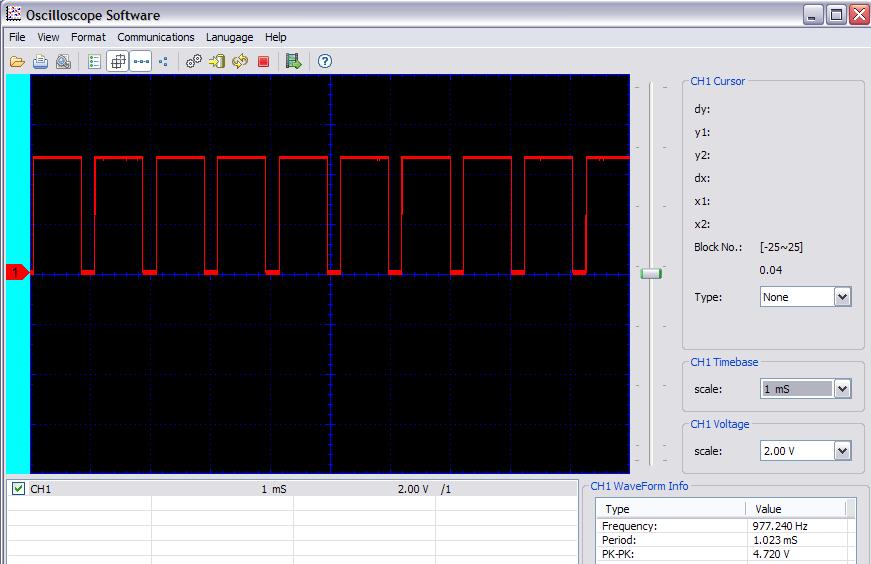

    Sure! Post what you have, and I will send you some oscilloscope shots.

    Here is the result. It changes from off through the percentage points to all the way on, but the period remains constant at about 1.023ms. (I finally got my oscilloscope USB driver to work today!)

    Thank you soooo much. What a great tool..
    Two things for me to consider.
    1. PAUSE seems to not have the affect I expected.
    2. The PR2 constant must mean something to PBP, but I can not figure out what.
    Lastly, which version of oscilloscope software do you use? Is it freeware or did it cost money. If so, how much?
    Ken

    Here some scope info that you asked me about. It is a stand alone, but has a USB port and free software that comes with it. It cost just under $300.00. http://picbasic.co.uk/forum/showthread.php?t=12483
