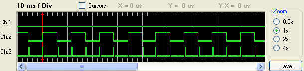

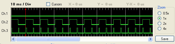

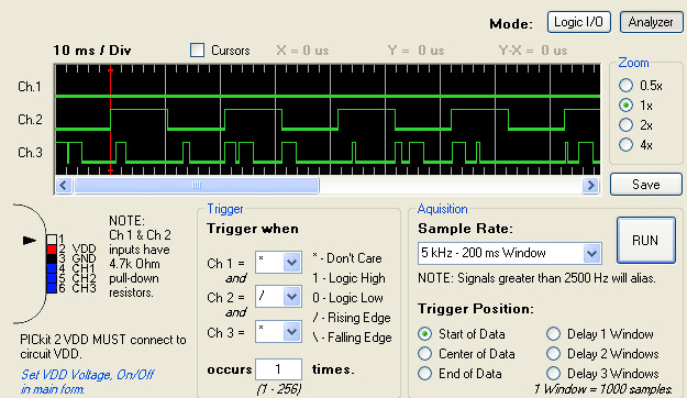

    Yes, "blocking commands" is exactly the word. I figured that out while lying in bed with the LOGIC TOOL image in my head. I could see that the length of the pulse was being added to the interrupt time. I could not find any information on that in any of my documents. Please tell me where in which .INC file is the ASM code which is activated by PULSOUT. Without access to those details, PBP is just guess work.
    My plan is to insert counters into the interrupt service routine. Every four interrupts (20millisec) do a PULSOUT. Every 25 interrupts, TRIGGER one SONAR or the other alternatively. My TRIGGER is built of HIGH and LOW commands totaling 10 microseconds (or so). These are not blocking.
    I'll give this a try and see how the car reacts (if at all.....)
    Thanks again for the support.
    I would approach it a different way, and avoid that pain. Especially since interrupts may grow on you, and you may get rid of your pulsin/out someday ! Say you want an interrupt every 20 ms and have a single servo to control, but you want to use pulsout since you are still learning interrupts. Since we can be a little off on our 20 ms, as Bert mentioned, the easy way is to say the average servo pulse is 1.5ms, so I need to interrupt every 18.5 seconds. If you add in the time of your pulsout, it will be very close to 20 ms, and your servo will be happy and grateful.

    see, this is one of the reasons I love this stuff. To do what Walter describes, with the same resources (1 interupt and pulsout), I would set my timer for 20 ms. My int handler would set a flag, and I would get out. Then in my Main, if the flag is set, hit my pulseout routine and clear the flag. This way I would get a new pulse every 20 ms on the dot. But mostly cuz I just always want to get out of the handler. I seem to feel like by name "Interupt" I was busy doing something before I went there. Maybe it was important and I need to get back to it.
    As for PBP being guess work, I don't think thats the case. Pulseout/in serout/in and the rest of them, take exactly as long as you think. if you PULSEOUT for 1 ms, thats how long it will take.

    Walter, I like your idea of the 18.5 ms plus servo out to make up the 20ms loop. I need just that for my project. I will want to use 1 timer to control the loop and the pulse, so that seems the best idea to me.

    It was a wire I had added to give the LOGIC TOOL more information. I do not understand why the PICKIT objected. But all is well.
