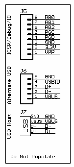

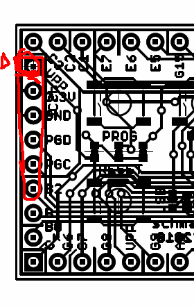

    scalerobotics, I thought that you suggested that J5 will work with the PICKIT USB connector.
    I can not find J5 on the board. I can find J6 but not J5. I downloaded the .pdf file which is a picture of the board. It is sooo messy that I can not find J5 on it either.
    HELP.....

    Default I found it
    J5 is the tail end of the board...
    Hmmm.

    Too bad it is not silk screened. That would have been helpful. I assume you are looking at this. Which could be a lot clearer. http://www.sparkfun.com/datasheets/D...MX460_v262.pdf

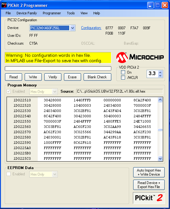

    I WROTE my .hex file into the PIC32. It did not object too much. Now what? Small addresses in the FLASH remained 'FF'. Here's a shot of the transition.
    1D0069C0 FFFFFFFF FFFFFFFF FFFFFFFF FFFFFFFF
    1D0069D0 FFFFFFFF FFFFFFFF FFFFFFFF FFFFFFFF
    1D0069E0 FFFFFFFF FFFFFFFF FFFFFFFF FFFFFFFF
    1D0069F0 FFFFFFFF FFFFFFFF FFFFFFFF FFFFFFFF
    1D006A00 0F401A8E 00000000 0F4073A0 00000000
    1D006A10 1000FFFF 00000000 27BDFFE8 AFBF0010
    1D006A20 40046800 0F402166 00000000 8FBF0010
    1D006A30 03E00008 27BD0018 27BDFFD8 AFBF0020
    1D006A40 AFB3001C AFB20018 AFB10014 AFB00010
    1D006A50 3C0204C4 3451B400 0F4073EA 24130005
    1D006A60 00409021 24030040 3C02BF88 AC432004
    1D006A70 02201821 00008021 3C02FE36 34453C80
    Now What? Does it dance and sing? Do I connect a hyperterminal via an old fashioned USB cable to the provided USB connector? Do I push the RESET button and the PROGRAM button? Any ideas?

    Ok, so now we plug the usb cord into the computer, and see what happens. If you have windows 7, there is a .inf file to download first. It's LED's may dance and sing, but you may have to configure that, to let it know where the heartbeat LED is. If you don't have windows 7, and it is not recognized when you plug it in, you might need to download the FTDrivers at http://www.ftdichip.com/FTDrivers.htm
    Check out page 13 of the manual. In your computer, goto the Device Manager screen and see what port gets added to your computer. Should be an extra USB Serial Port (comx). Use hyperterminal or similar program to connect to comx.
    You should get a nice welcome message like on page 14 or so of the manual.

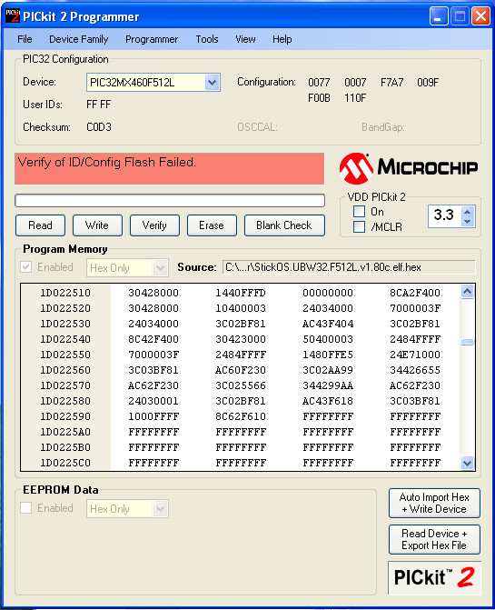

    The .hex file does not load. It says that MAXIMUM must be greater than or equal to zero. In fact it is -7xx or so. Here's the error printout.
    ************** Exception Text **************
    System.ArgumentOutOfRangeException: Value of '-749' is not valid for 'Maximum'. 'Maximum' must be greater than or equal to 0.
    Parameter name: Maximum
    at System.Windows.Forms.ProgressBar.set_Maximum(Int32 value)
    at PICkit2V2.FormPICkit2.ResetStatusBar(Int32 maxValue)
    at PICkit2V2.PIC32MXFunctions.P32Write(Boolean verifyWrite, Boolean codeProtect)
    at PICkit2V2.FormPICkit2.deviceWrite()
    at PICkit2V2.FormPICkit2.writeDevice(Object sender, EventArgs e)
    at System.Windows.Forms.Control.OnClick(EventArgs e)
    at System.Windows.Forms.Button.OnClick(EventArgs e)

    For what it's worth, on my Explorer 16, with a PIC32MX360F512L mpu:
    It accepts the hex file (different one of course) from my Pickit2.
    I can get a command line interface with my serial port (this chip does not have usb on it).
    When I try to connect command line interface with my PicKit2, I get almost no response. I do get a square box at some baud rates, but that is about it.
    Not a very good test, since there are a lot of differences, but it might be better to stick with USB for now.

    Default Here's my embedded hex
    scalerobotics - Mine looks just like yours!!

    Default The checksums are different..
    mine is C0D3
    yours is C15A
    Weird!

    Default Oh, yea, the error message
    That came after I hit the WRITE button. I was asking it to load that .hex file. It seems to load mostly correctly, but comes up with that funny error.

    Are you sure your pickit is plugged in right because it should be verifying the I'd. Mine was verifying air, so that's why mine has that waring

    The BIT Whacker schematic shows the connections from the 4 pin USB port [UBUS and USBID] to be different than the connections from 5 pins into J6 [PGB,PGC and RB2].
    I think you are sticking your Pickit in the wrong port.
    I know they are not spelled out as nice as the schematic, but, your pickit goes on J5 (same one I mentioned earlier). Later, after programming, you can try to plug in the usb host cable. The other 5 pin spots on the board are for USB.

    Here is where it goes. Should be a lot happier now...:
