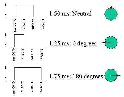

    Default Pulse width measurement
    For pulse width measurement, I ran across an interesting page.
    http://www.mcmanis.com/chuck/robotic...e_measure.html
    I borrowed a little bit of the code, and then added it to some DT_Interrupts. I am just measuring a servo pulse width, and sending raw tmr1 result to the serial port here, but you can change it to make it do other things. This was done with a PIC18f2520 in a LAB-X2. But the above gentleman used a PIC16F628, so it should be pretty flexible if you chose the corresponding DT_INTS include file. I would like to see more examples of pulse width measurement as well as pulse generation using interrupts, so if you have some, please share!

    Default I agree with using interrupts to measure time
    Scalerobotics.
    I have not been successful getting the RC knowledgeable folks to come clean with the exact signal pulse width specs. The hobby RC folks at our local RC Excitement racetracks and store
    http://www.rcexcitement.com/
    say that neutral (braking) is 130ms. This makes sense if the max pulse size is 256ms (2 to the 8th for convenient digital counting). How often that pulse is expected I am not sure. I think I read that the shortest pulse is about 50ms and the longest about 200ms. But I have no idea where or how I got that impression.
    It would be nice if I could implement a program on my PICkit such that my eyes could detect this variation by observing the glow of an LED.
    I neither own an oscilloscope nor have easy access to one. I do have some contacts at the Fitchburg State College Computer Science Department. I could call them and take over my car for a definitive answer.
    Enough talk. I'm supposed to be thinking and tinkering.
    Ken
    Most of the RC stuff out there uses something like this, but there are exceptions:
    And it is done 50 times per second, or every 20ms.
    The hobby RC folks at our local RC Excitement racetracks and store say that neutral (braking) is 130ms.
    I think the guys at your RC Excitement might be off by a decimal point or two if they are telling you neutral is 130ms.
    If that was neutral, it would take about 1 second to make any corrections to steering or throttle. In my mind that is a little slower than you need for a fast car like the one I saw in your other thread.
    Most RC receivers send out a pulse, one at a time, to each servo. So with the longest (2ms) pulse, an eight channel receiver can still fit all 8 x 2ms pulses in the 20ms bandwidth given by the cyclic 50 times per second update rate.

    Smile Success - the wheels go round
    This PWM exercise is designed just for what I have done.
    http://www.melabs.com/resources/samples/pbp/hardpwm.bas
    After loading the .hex into the RC car (carrying my PICkit2), hooking up another battery and connecting CCP1 to the electronic speed control, The wheels spin!!
    Ain't technology grande!
    Ken
    COOL!!!
    Another piece down!
    Did you get Walter's PWM reading code to work?
    If so then maybe now you can combine the two.
    If incoming PWM is X then wheels turn sort of thing?
