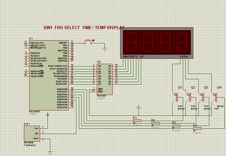

    May 2005
    70
    here is circuit ...
    I cannot attached some picture file..
