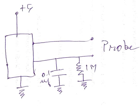

    448
    Quote Originally Posted by ShortBus View Post
    - Using and ADC channel to read the resistance across the probes. Normal state should be infinite resistance; anything less and sound the alarm. However, I don't know how to use ADC to measure resistance. According to the datasheet, the max recommended impedance 10k for ADC is anyhow. So I don't know if this is a poor idea besides the point.
    You could use the ADC input, or use the input as a digital pin. Essentially, the resistor between the pin and ground, and the water body would form a potential divider. With no water, your ADC reading would be almost, or equal to zero. When water bridges the probe, it should get close to the full Vdd (200+, for the resistor value I have used).
    Alternately, if you're using the pin as a digital input, it would be low till water bridges the probe, and then swing high.
    The 2nd version of the schematic would be even better, where you control current going thru' the water, as you could reduce the corrosion by a very significant amount.
    BTW, please excuse the shabby drawing, thought it would be faster than drafting it.
    Anand

    Anand,
    Thank you for taking the time to sketch out your schematics! It's a big help.

    448
    You should be fine with stainless bolts as sensors, as long as you've properly insulated / epoxied the connection between them and the wire. Plus, if you can, run the pic off a 3 volts supply, the probes will last that much longer.
