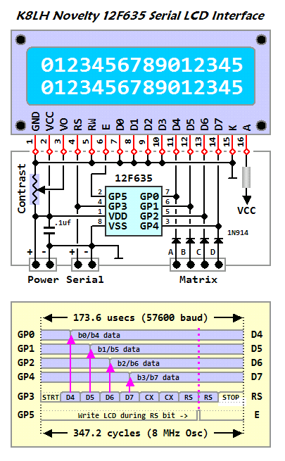

    Someone on another Forum asked me if it's possible to use the LCDOUT function with my old Novelty Serial LCD Interface (a simple 1-pin interface experiment inspired by the Predko 2-pin shift-register interface).
    The interface uses standard Async' Serial data but in a rather exotic format where each byte is sent as two bytes, one nybble per byte, along with the LCD 'RS' bit.
    ;  host low level K8LH Novelty 12F635 Serial LCD Driver

    Can the LCDOUT function use a custom driver like the one above (after being upgraded to catch the special $FE character)?
    Kind regards, Mike

    I must be missing the point. If it is wired as shown just use the normal LCDOUT. ???
    How is the 2 pin or 1 pin thing you mention wired?
    Hi, Dave
    I think this might be some kind of serial to parallell converter ... trying to use the minimum pin count device ...
    might be used for a very particular use ...
    The Question was " Can I use THAT with PBP "LCDOUT" Command ??? "
    so, the answer is NO ...
    May be some SEROUT2 with modifier for 4 bits data out ... ( to be confirmed )
    OK, I see what I was missing now. This is a LCD Backpack thing.
    Interesting...
