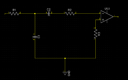

    The circuit :

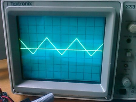

    The input / output (this is what I'm reading on the PIC pin RA1 and output on RA5)
    Thanks .. please convey if you have any idea why I'm not seeing a nice square wave on RA5 of the pic !
