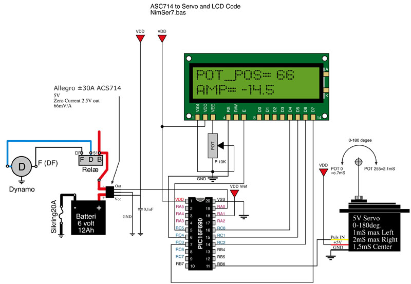

    Default Diagram we use
    I drew this diagram to illustrate the different units involved.
    For a numeric value of 166 read from the analog-to-digital converter, Darrin's equation brings back 11.58 and Mackrackit's brings back 11.47.
    They are close enough given the low resolution arithmetic taking place especially if you just round up to no decimal places.
    I can attest to the annoyance of one meter showing 9 Amps when the equations bring back the numbers above.
    http://www.picbasic.co.uk/forum/albu...0&pictureid=25
    Last edited by ukemigrant; - 3rd August 2009 at 01:06. Reason: Stupid image did not show up

    Default Re: PIC 16f690 Allegro ACS712 + -30Amp
    Is this the way to get negative reading? i am new to this, so sorry if i mixed it up.
    I use Allegro ACS714 but with a PIF16F690 with A/D set to 8bit, should not be any difference.
    It works and can read +30Amp to -30Amp.
    The problem is that i use 0V and 5V as reference. I cant figure out to get 0.52V to read 0 and 4.48V to read 255? Is it a math problem or must i add an external ref?
    The ACS gives 66mV/A:
    Amp Vin Bit
    +30A 4.480 255
    +10A 3.160
    +1A 2.566
    0A 2.500 127
    -1A 2,434
    -10A 1.840
    -30A 0.520 0
    See CODE below and attached DRAWING
    Name:  ASC714 to LCD.jpg
