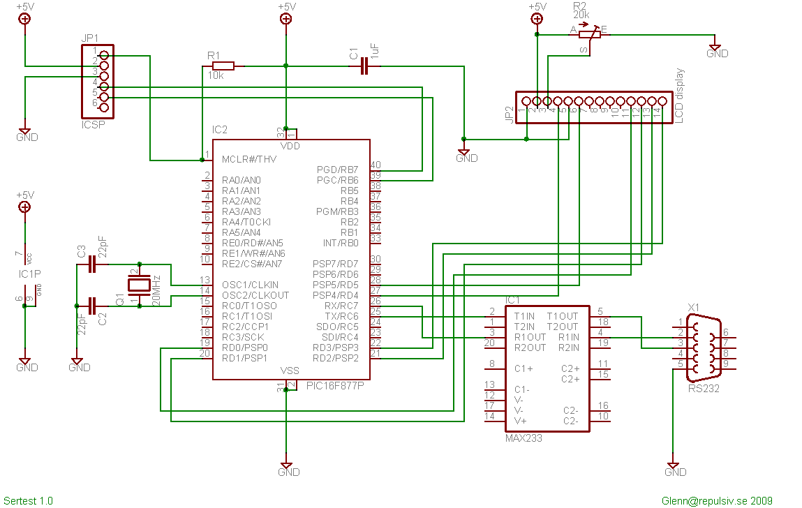

    I'm building a thing that really could use some serial out and input, so I decided to try to finally use the USART's in some pics..
    First I tried to get it to work in my nearly-finished testrig for the rest of the stuff, but when this didnt work I built a "serial testring" to be able to sort out the problems.
    But no. get nothing in my term program.
    This is my testcode..

    ..I tried different things, but this should work ? or ?
    I attached a schematics of my simple testrig.

    Hrrm, yes, I can see that I forgot two things in the schematics, first of all the MAX233 have a 1uF cap close to its Vcc and gnd, and I also put a swicth that change the position of RX/TX coz you never know what you connect it to.
    I set my terminal program to 9600bps 8N1, no flowcontrol.
    Looks like pins 2 and 3 on the DB9 backwards?
    I did not see the part about the tx/rx switch.
    Do you have a copy of Pic Multicalc?
    http://www.picbasic.co.uk/forum/show...24&postcount=4

    Yea, since I use a cable that is crossed I connected it that way, but later I added the switch that change the positions, mainly coz I wasnt really sure how it should be
    Yea, I have picmulticalc, but I didnt really thought of that it had USART help.
    And yes..
    I choosed 20Mhz 9600bps and copied the defines to my code (replacing the old ones), and voila, it worked.
