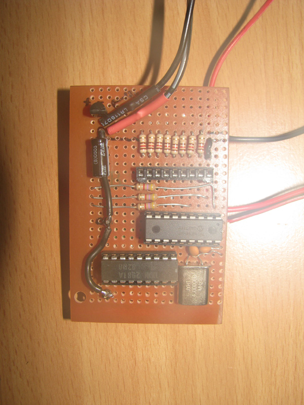

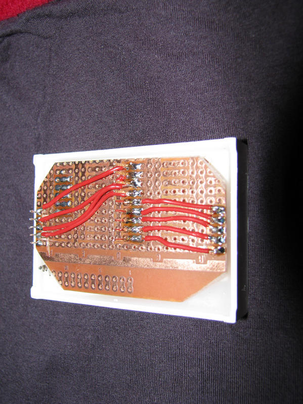

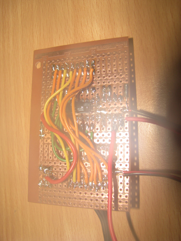

    Hi All,
    I've been wanting to do this project for a while now and have finally gotten around to it.
    I've built a single digit clock using a 2.3" 7 segment LED (green in this case). The clock flashes each digit in the time for one second before displaying the next. It also lights the DP on the second hour digit.
    There are 2 push buttons for setting the time as well.
    Here is the code and a couple of photos of the boards.
