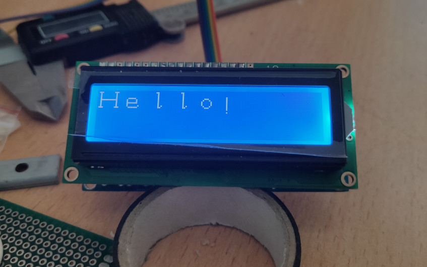

    As found out by brute data sending, if you want to display large size English letters, you should use
    LCDOUT $FE, $80, 163, 128+ASCII character code.
    LCDOut $FE,$80,163,128+72,163,128+101,163,128+108,163,128+108,163,128+111,163,128+33 'Will display Hello! with large letters
    Just these letters are as ugly, as most common Latin letters in Chinese fonts Also they're monospaced and use whole 16x16 area.
