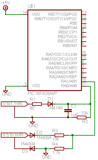

    I've got both comparators hooked up on my PIC16F628A
    I've attached the simplest schematic I could draw to describe the setup I have (The full version also uses digital pins, hwserial, 2 LDR's hooked up for POT and the pwm.)

    Basically, it runs in a 10 ms loop for dimming led's attached to the pwm and reading two LDR's with the POT method. If serial input is detected it interrupts and goes to deal with the byte/s received, if one of those bytes is a 7 it reads the first comparator 3 times, if it's an 8 it reads the other.
    Now, the problem I have is with input to pin 18 at 0.00v (as measured by my multimeter) the output looks like this 1110001011101011 (read from the serial port at the rate of 1 per second)
    With pin 18 at 0.76v (the input is at 1.1v) it's fine, and happy to read 1111111111111111
    Pin 17 is even worse off. at 0.12v (which is as low as it goes) it reads 1111111111111111
    and it doesn't change when it goes to high or low...
    Edit: PS I think I have it set up so that both comparators are hooked up to the internal vref and that it's running at 0.62v
    So um... can anyone tell me why a) pin 18 is noisy and all over the shop... and b) pin 17 just doesn't work?
