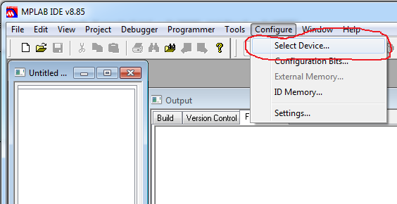

    Default Re: Need help / verification error and invalid target id warning PIC16F877
    Have you selected the correct target device in the MPLAB IDE?
    Name:  Select device.png
    If you have then it sounds to me like a problem with the communications between the device and the ICD2. But I don't have any experience with the ICD2 debugger/programmer...
    yes it is the right device.
    If thats the case,then what are possibilities that can make that go wrong?What do i need to do?
