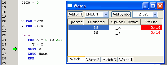

    Have you tried opening the watch window, and selecting your variables?
    It works fine for me. Never tried mouseover, but I definitely can watch variables change
    when I have the watch window open. And they change as the PBP program runs. It doesn't
    need to be stopped before they update.

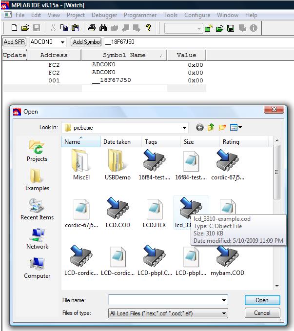

    The variables you declared in the PBP program should appear in the watch window Add Symbol dropdown, but an underscore "_" will be appended in front of the name. ("myvar" shows as "_myvar".) The exception to this are BIT-variables, which will not show by name.
    In the build options for the source file, make sure that "Use MPASM Assembler" and "Source-level Debug" are checked.
    You will need to specify the type of variable by right-clicking in the watch window after you add the variable. All variables are displayed as bytes by default.
    Charles Leo
    microEngineering Labs, Inc.
    http://melabs.com
    Looks like you can go to File, then Import, then selected the file.cod file, and then you can select your variables. Very nice Bruce, I did not know that either.
    <img>http://www.picbasic.co.uk/forum/attachment.php?attachmentid=3393</img>
