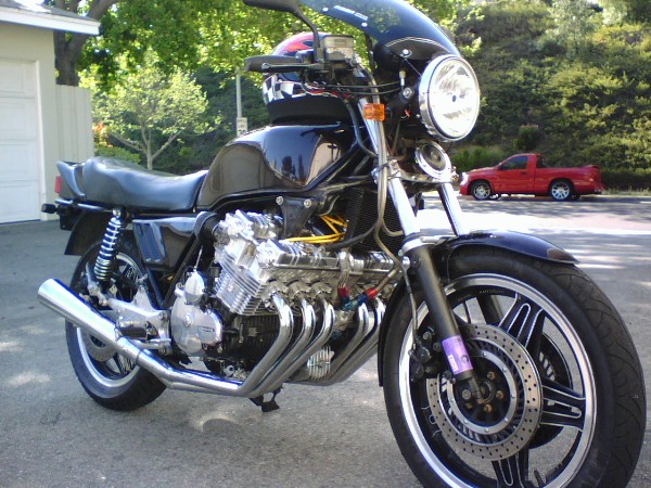

    Default bike road trip
    I leave for a road trip in the morning to Zion National Park, The Grand Canyon, Hoover Dam, and other places on my CBX. I wil have to order the flow meter when I return, the time difference makes it difficult to order. What bike do you have Gusse?
