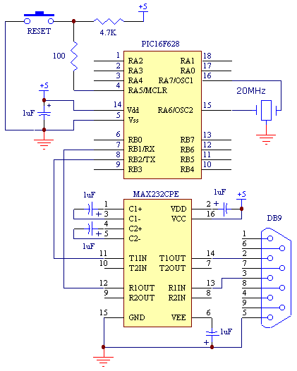

    Also if you have a diagram of the circuit that works, I would be very greatful.

    Hi loredana,
    I'll suggest you to download MicroCode Studio there : http://www.rentron.com/mcstudio/mcstudio.exe
    One circuit example is already in the HELP TOPIC under ICD>Introduction>>Harware Setup. By the way i attach one example.
    With MicroCode studio you'll be able to send and receive to your PIC in the same windows task.

    Thank you also for the gif with the diagram, that helped a lot aswell.
