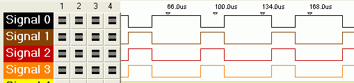

    Look at the attached graphic. Note how signal 0 & signal 1 would make it look like one LED
    was on all the time, while the other was off all the time. Complementary mode is for driving
    N channel & P channel motor drivers. It's a lot different than standard PWM.
    If the duty cycle was say 70%, one pin would be high for 70%, the other would be low for
    70% since they're complementary.
    Signals 2 & 3 are in independent mode, so the high duty cycle is the same for each pin.

    Darrel: thanks for the pointer to Bruce. I've got the registers set for a much lower frequency than Bruce's example - my CCS can only work at 200Hz max so I should be running at 154Hz with the values I've picked. Also I made sure with OVDCOND that nothing is over riding the PWM. Well, that's what I think I was doing
    Bruce: so what I want is the behaviour you show for 0 and 1, I want to output the inverse of the programmed duty cycle. What I see is PWM.1 ramping up and down while PWM.0 seems to stay constant. If i put them into independent mode (PWMCON0 = %01000011) then PWM.0 and PWM.1 ramp up and down together - same as your signals 2 and 3 - which sanity checks my wiring.
