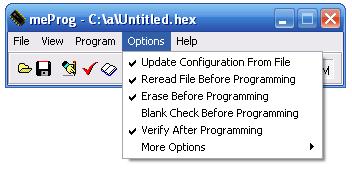

    1 -it will be enough to setup the fuse @ __config _LP_OSC and to setup the programmer (melabs U2 Programmer ) to update by itself the "Configuration From File" ?....or i have to comment the *.inc file also?

    .... so do you think i should add one resistor there ?
