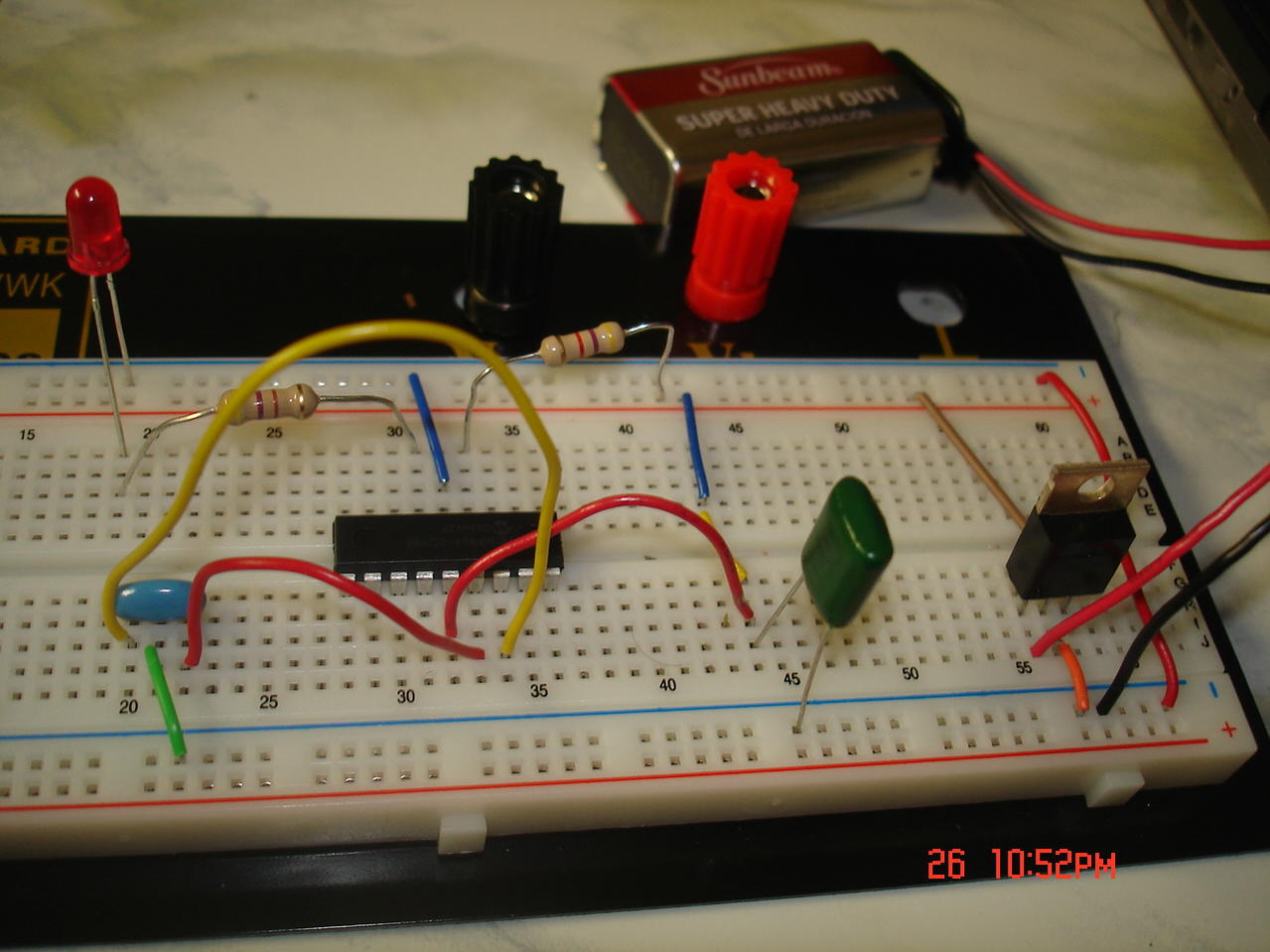

    i appreciate your patience, i am just wondering about the diagram, please check the attachement. i have tried with 2 microcontrollers. is there any way of checking the microcode programming / fault pic .
    Hi shafi008,
    Ok this picture looks much better, I HAVE FOUND, on some low cost breadboards, the power bus strips have gaps that must be bridged. I have some like that which needed 3 jumpers to make the strips have continuity all the way across, so just for practice, please use a meter or led and check yours, just to make sure.

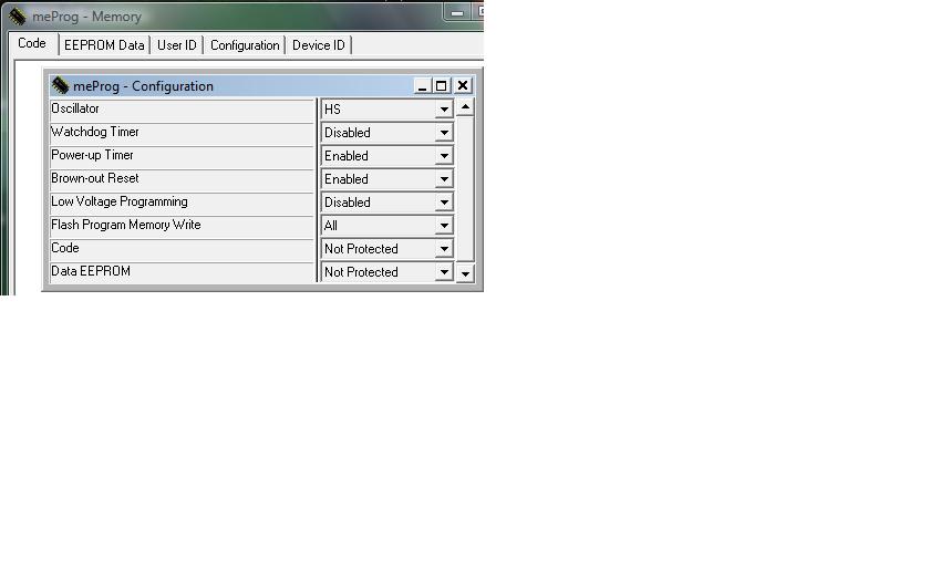

    When you program it with your melabs programmer, can you check the fuse settings that are shown in the programmer. I believe there is a window you can open that shows you fuse settings. Can you make sure these are set correctly. The default settings that are in picbasic should do just fine. The file it is picking these up from is in c:/pbp/16f84a.inc
    You could post a screen shot of these fuse settings from your melabs programmer. What we are looking for is this window:

    Hi Here is the code what i am using and the attachment has the configuration.

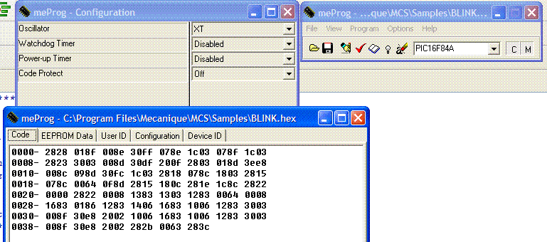

    OK I just downloaded ME PROG and set it up . . and that is where the hex you are using came from, it is a default sample hex, not your hex.
    When you click File . . . Open . . . The window that opens will list a directory tree and file name. You have to direct it to YOUR hex file located in Your PBP directory in whichever subdirectory you chose to save YOUR code in. That is why it is not working for you . . . Damn, it is the same . . . Hmmmm . . . OK again maybe the programmer isn't programming due to incorrect port.
