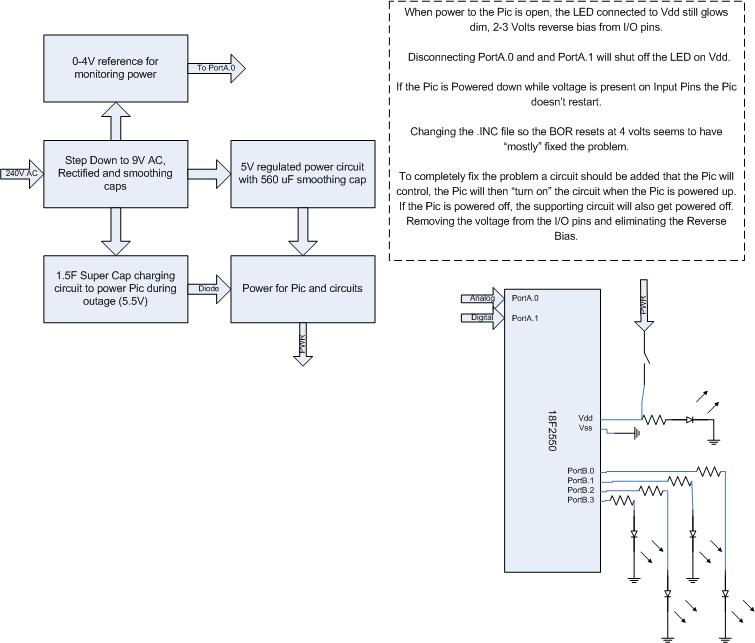

    Welcome aboard. The phenomenon you describe is known as back-driving. It is used extensively by in-circuit-testers (ICT) to verify the working of components on a populated board. I would like a look at your schematics. This might help eliminate the back-driving issue.

    Am I crazy thinking that this shouldn't have been something I had to fight with? There is a possibility that the pic will have voltage on the analog pin before Vdd when the entire circuit is powered up,
    Nope, you're not crazy. This is very typical of MCUs, FPGAs, and in particular ADCs. The inputs are diode protected (from datasheet "I/O pins have diode protection to VDD and VSS"), so if you apply power to the I/Os before applying power to the "core" guess what. You run the chance of reverse biasing the protection diode, and thus biasing the device through the I/Os.
    The best approach would be to not apply power to the I/Os before applying power to the "core" (i.e. make sure there is no possibility "that the PIC will have voltage on the analog pin before Vdd when the entire circuit is powered up"). This is sometimes inevitable, in which case you have to work around it. Buffering the I/Os is always the second best option. As an example, for the digital I/Os of an MCU you can use logic buffers (gates, latches, etc) which get turned on by the MCU after it has been powered-on; this way the I/Os are effectively buffered from the external world (sometimes series resistors could do the trick - but you never know). For analog I/Os you could use OPAMPs (again, which get turned on by the MCU). These are just suggestions, and I'm sure there will be others. But the main thing is that you are not going crazy, and this is something which has been tackled before time and time again.

    Thanks for the information, I don't feel like I'm crazy any more, sounds like it's a problem some of you have experienced before. I attached a simple block diagram of the circuit I have. There is more circuit to build, but I need to get this part working and be able to handle low voltage and brown outs and recover without a glitch.
    To sum up what I understand so far: If power is removed from the Pic, but power remains on the I/O pins, the pic will become reverse biased. This puts the Pic into a Brown out stage. The default BOR setting for the pic was 2 volts. Since there was greater than 2 volts still on Vdd, the Brown Out Reset was not "reset". Changing the BOR setting to 4 volts in the include file seems to mostly fix this issue.
    To completely fix the problem, I need to add an additional circuit. The pic will control the circuit so when the Pic is powered down it will shut off the rest of the circuit, removing voltage from the Pics I/O pins. Also, there will not be any voltage on the I/O until the Pic Powered up and turns it on.
    Let me know if I have this correct. I'm using some Opto relays and Opto Isolators in other parts of my circuit. I could add those to the inputs and have the Pic control those to remove voltage from the I/O's. Might be over kill but I have them and would be easy to implement.
    yup sounds right to me. Then you just need to choose the best solution for you, there's a load of possibility, from relay, to "digital switches", Mosfets, opamp buffers, and so on.
