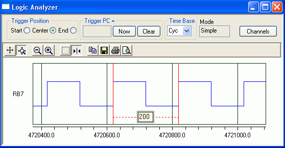

    2,405
    Using a PBP interrupt eats hundreds of instruction cycles just saving & restoring PBP system
    variables.
    You can get much more accurate timing, and save hundreds of instruction cycles with a
    CCP Compare interrupt & .asm interrupt handler.
    Try something like this;
      INCLUDE "DT_INTS-14.bas"     ' Base Interrupt System
        LED VAR PORTB.7
        OUTPUT LED
        LED = 1
        ADCON1 = 7
    INT_LIST  macro    ; IntSource, Label,  Type, ResetFlag?
        INT_Handler     CCP1_INT,   CCP_INT, ASM,  yes
    @ INT_ENABLE  CCP1_INT  ; enable Compare interrupt
        T1CON = %00000001   ; Prescaler = 1, TMR1ON
        CCP1CON = %00001011 ; compare mode, int when TMR1 = CCPR1
        CCPR1L = 100        ; interrupt every 100 instruction cycles
        CCPR1H = 0
    MAIN:
        PAUSE 50
        GOTO MAIN
    CCP_INT
        MOVLW  0x80     ; W = %10000000
        XORWF  PORTB,F  ; toggle RB7 on each interrupt
        INT_RETURN
    This should give you a 5kHz signal on RB7, with Timer1 reset by hardware. To change the
    frequency, just change the value in CCPR1 high & low registers.
    See analyzer screen capture attached.
    -Bruce
    tech at rentron.com
    http://www.rentron.com

    it is realy great bruce.
    I HAVE TO USE ASM INTERRUPTS AFTER THAT.
    The frequency is 5KHz.
