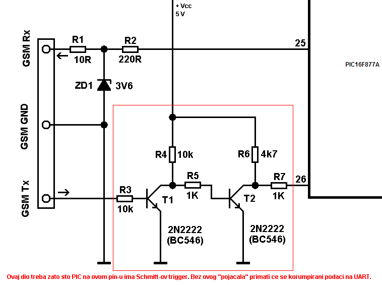

    i'm going to tried that!!! here is simple schematic of wiring pic and nokia!
    the first one is from admin of www.elektronika.ba, but with this circuit i dont get sufficient voltage on rx pin....i'm gona give shot to the second one tonight it' from some spanish forum!

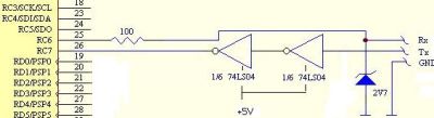

    and this is from www.atrox.at...as i mentioned before i assume the rx line of pic does'n responding, 2.4 V, and need it min 3.3V
    Mar 2009
    48
    Default thx
    thx ioannis for idea, and i put a hex inverter (invert signal from phone twice) in tx phone to rx pic line and the program is now working. so it search letter A in first readed message in SM location and if it find it turn on led on portb.6

    The Hserout/Hserin will NOT work with these circuits! Be careful also not to destroy your phone with this 3.3/5 volt adapters. I would suggest to test with the Serout2/Serin2 commands in invert mode.
    Hserout/Hserin pressume that you have included inverters in your circuit (like the common MAX232, which obviously there are not).
    I would use a 3.3 driver for the UART like MAX3232 for example.
    but it's working, i put a hex inverter 74LS04 and inverted the signal two times, 1 x 2 times logical not give 1, and put one zener didode 2v7 in tx line of phone!!!!so it's protected from over voltage!!!
