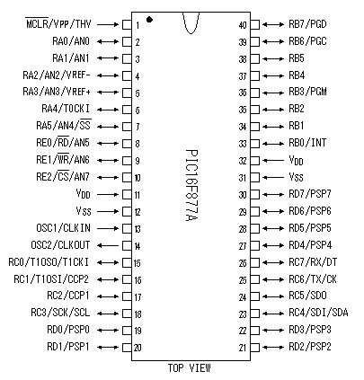

    PortA.4 is not responding though....it stays low
    for PORTA.4... well... it's an open-collector output type on this one. So you may need to slightly modify your hardware and software.
    http://www.picbasic.co.uk/forum/showthread.php?t=11116
    In brief, connect your LED between Vdd and PORTA.4, and change those
    PORTA = 0
    to
    PORTA = %00010000
    That should work for LEDs. If you drive a transistor but then it's easier... not software modification are needed, just hardware.
