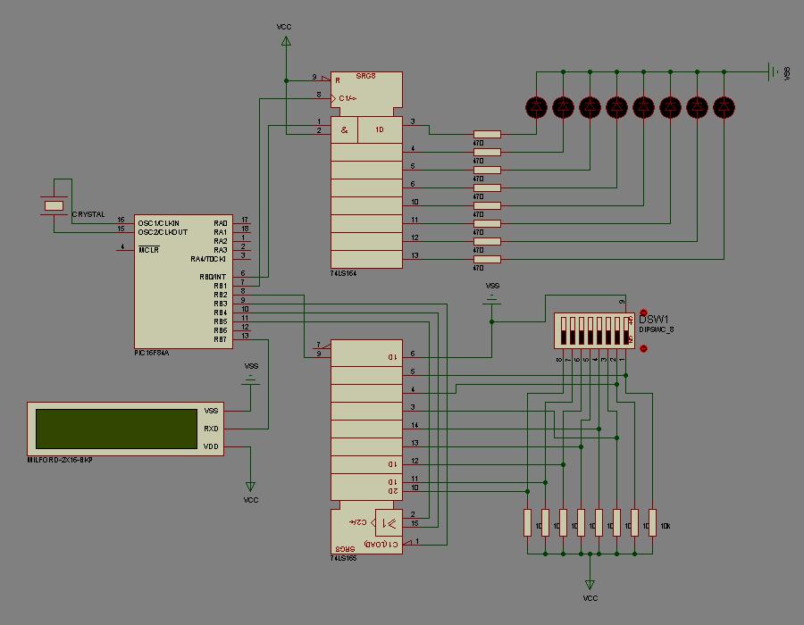

    I bought PIC Microcontroller Project Book for PICBasic and PICBasic Pro.
    Attached is my schematic drawing of what I am working on. The code and schematic come right out of the book on pages 173 fig 12-10 and Source is off page 175 program 12.6.
    Everything works perfect for turning on and off LED's. I have no idea what else I can do with this program. I see a lot of uses I would like to do but and unsure how to apply them.
    Example -
    On one of the input pins on the 74LS165 have a variable POT and read it's value. Then have a servo move according to how far the POT has moved on an output pin on the 74LS164.
    That is something I would like to make happen, but and unsure what would need to be changed in the code to make that happen.
    Any help would be appreciated. Thanks
