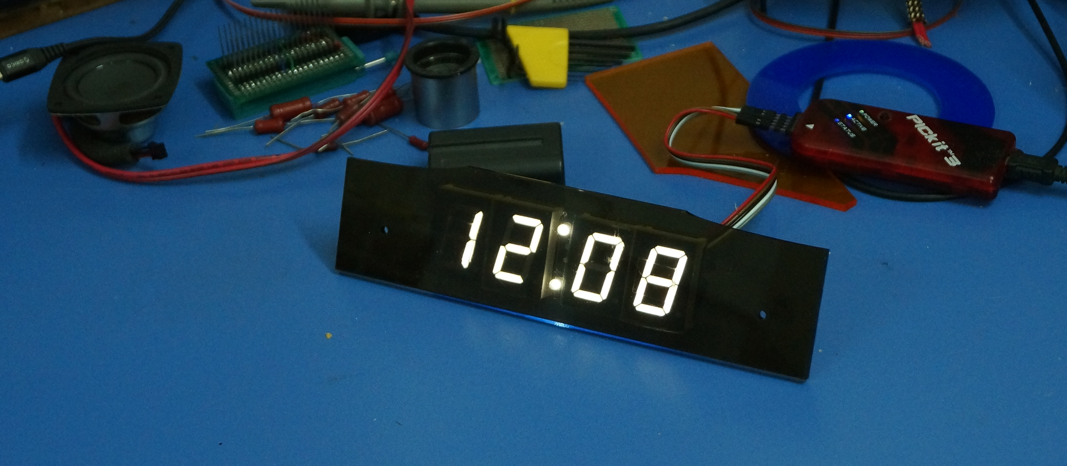

    I have 4 piece of 7 segment led displays connected directly to MCU pins, via 220 ohm resistor, common anode going to Vdd. I wrote a routine, which allows to display any number (X) on any digit (Y). But it is taking about 2.7k of memory, mostly because I can not redefine variables on the fly. So my main goal was to shorten this code somehow.

    Well my circuit is already built, software written and it works fine, just it takes about 7.3k memory, so I'd like to slim it down. If anyone want to build a LED clock, with directly driven segments, using PIC16F887 and DS3231, here's the working code (it needs some cleanup, unused labels and variables should be removed, but it works just fine as it is). I also can upload gerber files of PCB. I'm planning to add some extra features to existing hardware, like user digit style selection (US/EU/JP) and temperature measurement via DS18B20, but all this later.
    cfg1 = _INTRC_OSC_NOCLKOUT    ; INTOSCIO oscillator: I/O function on RA6/OSC2/CLKOUT pin, I/O function on RA7/OSC1/CLKIN
    cfg1&= _WDT_ON                ; WDT enabled
    cfg1&= _PWRTE_OFF             ; PWRT disabled
    cfg1&= _MCLRE_OFF             ; RE3/MCLR pin function is digital input, MCLR internally tied to VDD
    cfg1&= _CP_OFF                ; Program memory code protection is disabled
    cfg1&= _CPD_OFF               ; Data memory code protection is disabled
    cfg1&= _BOR_OFF               ; BOR disabled
    cfg1&= _IESO_ON               ; Internal/External Switchover mode is enabled
    cfg1&= _FCMEN_ON              ; Fail-Safe Clock Monitor is enabled
    cfg1&= _LVP_OFF               ; RB3 pin has digital I/O, HV on MCLR must be used for programming
    cfg1&= _DEBUG_OFF             ; In-Circuit Debugger disabled, RB6/ICSPCLK and RB7/ICSPDAT are general purpose I/O pins
      __CONFIG _CONFIG1, cfg1
    cfg2 = _BOR40V                ; Brown-out Reset set to 4.0V
    cfg2&= _WRT_OFF               ; Write protection off
      __CONFIG _CONFIG2, cfg2
    'nixie led clock electronics direct drive
    'include "modedefs.bas"
    OSCCON=%01110101  'SET INTOSC TO 8MHZ
    ANSEL=%00000000
    ANSELH=%00000000 'disable ADC
    TRISC=%00000000 'set PORTC as output all
    TRISD=%00000000 'set PORTD as output all
    TRISB=%00000000 'set PORTB as output all
    TRISA=%00000001 'set PORTA 0 as input, others as output
    TRISE=%00000000
    'OPTION_REG=%100000000 'disable portb pullups
    DEFINE OSC 8   'OSC SPEED
    'turn off all digits
    PORTA=0: PORTB=0: PORTC=0: PORTD=0 : PORTE=0
    'PIN CONFIG
    FEXI VAR PORTA.0
    'BUZZER
    low portA
    low portb
    low portc
    low portd
    low porte
    '1 digit
    A1 VAR PORTD.3: B1 VAR PORTC.4: C1 VAR PORTC.1: D1 VAR PORTC.2: E1 VAR PORTD.0
    F1 VAR PORTD.2: G1 VAR PORTC.5:
    '2
    A2 VAR PORTD.4: B2 VAR PORTD.5: C2 VAR PORTA.7: D2 VAR PORTA.6: E2 VAR PORTC.0
    G2 VAR PORTC.6: F2 VAR PORTC.7
    '3
    A3 VAR PORTB.2: B3 VAR PORTB.5: C3 VAR PORTA.5: D3 VAR PORTE.0: E3 VAR PORTE.1
    F3 VAR PORTB.1: G3 VAR PORTB.0:
    '4
    A4 VAR PORTD.7: B4 VAR PORTD.6: C4 VAR PORTA.1: D4 VAR PORTA.2: E4 VAR PORTA.3
    F4 VAR PORTB.3: G4 var PORTB.4
    DOT VAR PORTE.2
    'BUT VAR PORTA.0
    BUZ var PORTB.7
    SDA VAR PORTD.1
    SCL VAR PORTC.3
    'PORTA.4	UNUSED
    'dot
    'my time variables
    RTCYear  Var Byte: RTCMonth Var Byte: RTCDate  Var Byte: RTCDay   Var Byte: RTCHour  Var Byte
    RTCMin   Var Byte: RTCSec   Var Byte: RTCCtrl  Var Byte
    saatebi var word   'hours
    cutebi var word    'minutes
    clebi var word     'years
    tve var word       'months
    dge var word        'days
    DRO var byte       'temp time holder
    cvladi var word

    As I understand, this sequential access is good, but I can't use it with my PCB, need to design a new one...
    2,650
    Default Re: "Variable already an alias" - is there a way to avoid this?
    nonsense, you can map it to any configuration
