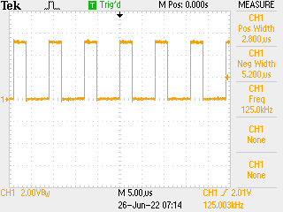

    However, this results in the below:
    Note that although it is exactly 125.0KHz, it is not symetrical and has an approximate duty cycle of 2.8us/5.2us * 100 = 35%
    maybe more like duty cycle of 2.8us/8us * 100 = 35%

    I found this:
    https://www.micro-examples.com/publi...alculator.html
    Which produces this:
    PR2 = 0b00001001 ;
    T2CON = 0b00000101 ;
    CCPR1L = 0b00000100 ;
    CCP1CON = 0b00111100 ;
    Running that results in 3.8 / (3.8 +5.2) = 47.5% which is much closer.
