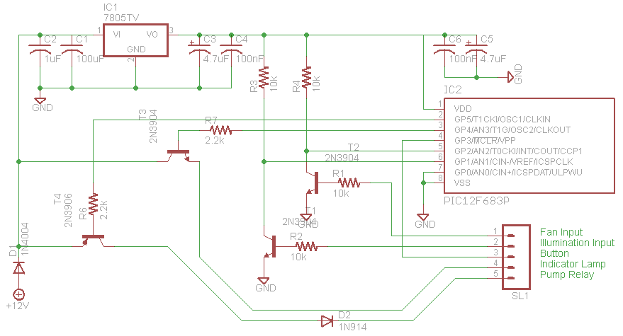

    use this diagram, I forgot to add a few things..
    R3 and R4 will give you some problem, this makes a great voltage divider but will give you false logic level.
    Is this a Typo or those 220nf are 220uF?
    something is weird in the way you hook Q3 and Q4

    Yeah, GND must be Vdd...

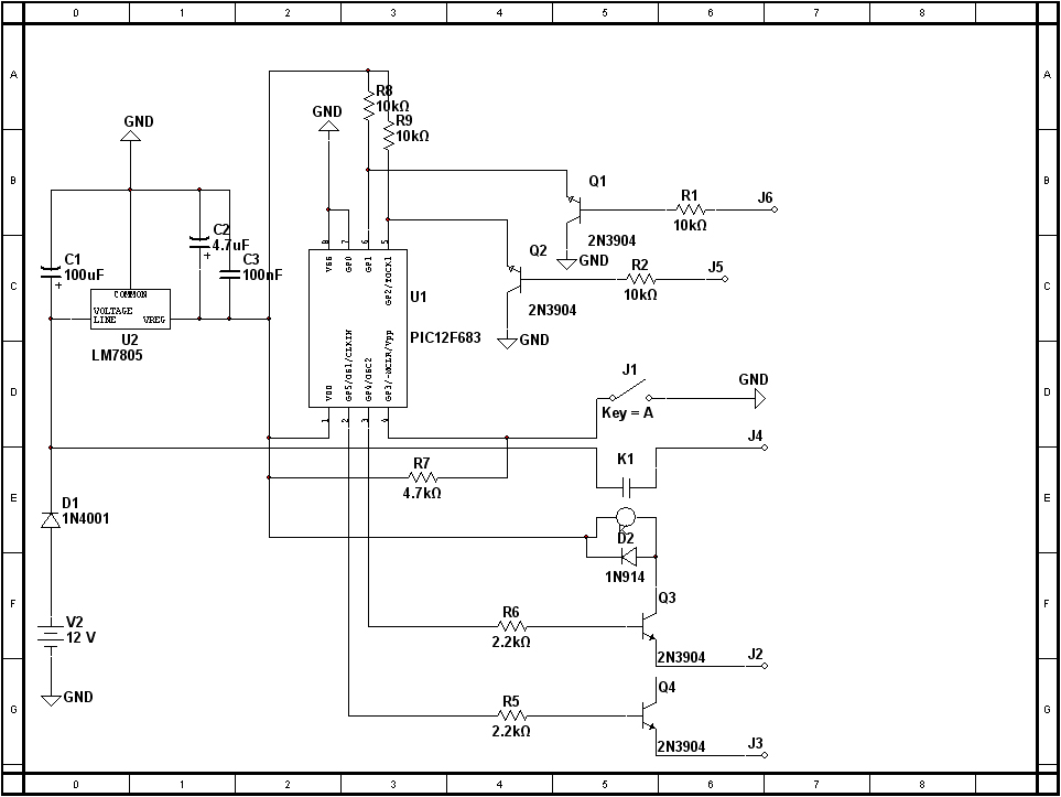

    yea, no idea what i was thinking when i threw those together, I had it differently just read my notes wrong, really wrong... anyhow, look at this one

    Definitely better, but... Q1 and Q2 are not connected the proper way, the emitter should go to GND, I'll assume a lack of sleeping for this one
    I would suggest few things
    1. add a 0.1uF capacitor at the regulator input
    2. assuming Q3 drive a relay (because i'm not sure of the symbol you're using), I would suggest, if at all possible to use a 12V relay, this will keep spikes far of the logic Vdd. OR, depending how much current your relay coil need, and if have tons of those, add a resistor in serie with the 12v line...
    3. D1 is a good idea as long as your load on J4 don't overload the maximum forward current, which is ~1A.
    4. Depending how much current and where your LED take it's voltage, you may don't even need Q4

    You are right about Q1 & Q2 they are supposed to be connected to 5v not gnd.
    Q3 is driving a relay, that is National Instruments idea of a relay symbol and it pulls about 40mA
    J4 will have about 140mA
    The LED is actually an incandescent bulb needing ~12v 80mA
    erice1984, The way the schematic is drawn the emitter and collector of Q1 and Q2 need to be reversed...
    For 140mA drive, could the relay be replaced by a Mosfet or transistor instead?
    Aye, Thanks for pointing that out, Q1 and Q2 are correct, I have the resistors connected incorrectly, they should be hooked to ground instead of the 5v that the diagram is showing..

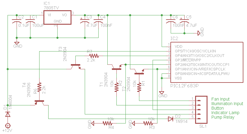

    how does it 'appear' now?

    *sigh* That is irritating....
    Fixed T1 and T2

    Yet again, another change.... am I the only one this happens to?

    erice1984, few comments on your last schematic.
    a) NPN transistors are wrongly used (emitter should be grounded).
    b) PNP should have a base pullup resistor (4,7K will work).
    c) Diode D2 should be placed across emitter and collector of T4 to be of any use.
    d) Connector SL1 has two wires missing, since you will need ground and Vdd

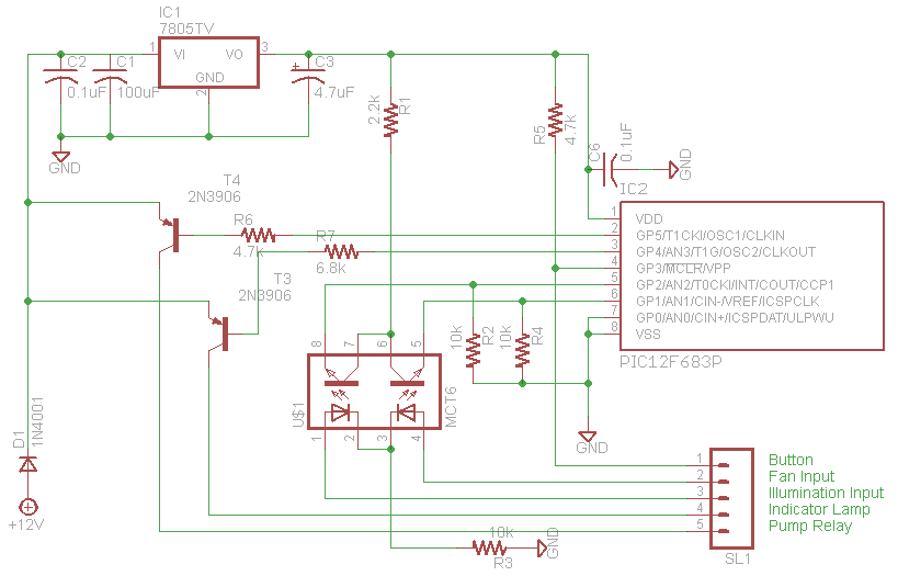

    I was thinking of replacing T1 and T2 with Optocouplers.

    schematic .
    Why T4 is PNP, but T3 is NPN?
    Opto-Coupler will not work as-is. You should tie collector to VCC, emitter to your PIC I/O + Pull-down. Or variant of it, emitter to GND, collector to your I/O with a pull-up. Internal ones, if available on these pins, could work. Assuming the signal are 12V (or something over 5v), a simple current limiting resistor, or voltage divider could also work.

    Okay, made sense about the Transistors. I changed the NPN to PNP because they were seemed better for the job.
    I also added 10k pull-down resistors to the emitter-PIC I/O wire.

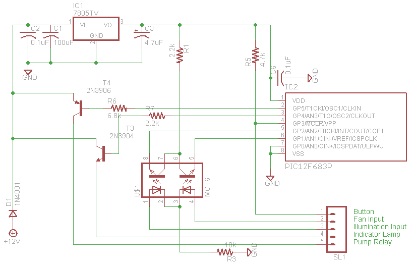

    okay, I figured why am I using 2 more resistors than I need to. I took your advice changed programming a little and used the internal pullups, check it out.
    Default T3 - t4
    I don't think those tr's will work like that, you need 12v on base to turn off and PIC pins only go to 5v. Need to have PIC drive PNP to drive base of NPN or make tr low side switches of PNP.

    true...
    I never did it, but I think It could work. Use a pull up between tr base and 12V, then a resistor in serie with the PIC. In your software, you set GPIO to 0, and later you play with TRIS to toggle your pin. Set to input, the tr should be off, Set to Output, tr should be almost ON. I would bet something like 10K pull-up, and something like 100-1K match could do.
    I have the feeling that the internal zenner diodes will keep your lower side of the resistor to 5V+ even if you force it in input mode so the transistor will never turn OFF completely. Playing with the two resistors values will only get you a reliable ON status of the transistor but never fully OFF.
    Nick
    Those internal one are not zener, but regular one.. fluffy but regular. Anyways, forget that, it was a really bad idea
